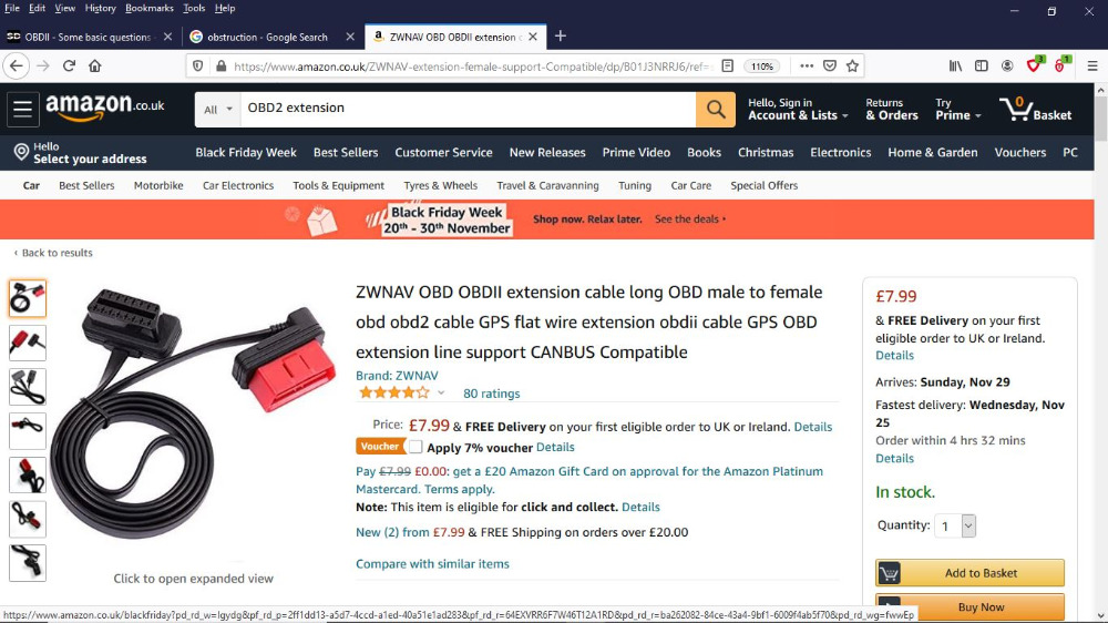

Plug-in cable extensions for 16pin OBD2 are easy enough to find you can get ones with side entry plugs and slim cables. I have a couple as some of the cars I work on have the socket obstructing the brake pedal. You can also find extension cables with switches.
Diagnostic dongles generally draw about 25ma parsitic drain ---- roughly doubles the overnight parasitic drain on a small car not a problem if the car is in everyday day use but it can cause issues if the battery is failing or the car is parked up.

Yes, they are easy enough to find. If you use one that's good enough for me, thanks.
This dongle claims to draw 30 ma. in sleep mode and supposedly can be set to turn off and draw nothing. I don't know yet. Bluetooth LE is new to me and I spent a ridiculous amount of time trying to pair mine, only to learn that you don't pair these. So I'm still futzing with it. amzn.to/3lYZ2Tw

I don't use that particular one --- these things are so generic that it is just an example of one with a nice flat plug. AES Wave to extra long ones with a fat cable.
