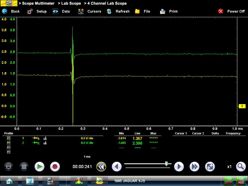

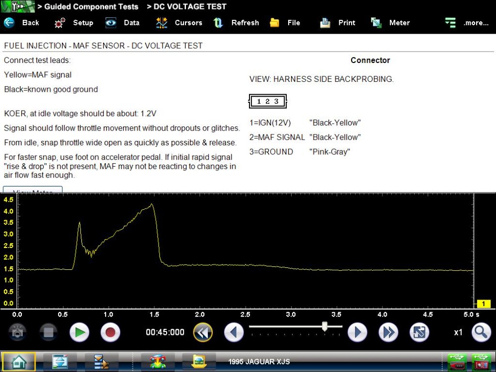

Background info- trying to determine if a MAF sensor on a 1995 Jaguar XJS 4.0L engine is faulty based on scoping.
Attached, please find 2 pics:
- Pic 1 - I am in my "Guided Component Test > DC Voltage Test" and trying to determine the health of the MAF. As per Pic 1, you can see the MAF voltage is at about 1.5 V as the engine idles.
- Pic 2 - a glitch caught when monitoring the MAF signal (Channel 1 noted in yellow) and the IAT sensor voltage (Channel 2 noted in green).

- does the "lapscope" feature on the Verus have a higher resolution and sampling rate then the "Graphing Multimeter > Volts DC" meter on the Verus? I never caught the glitch when in my guided component test portion of the scan tool, however, I caught a glitch when in the lapscope portion of the Verus.

It does indeed have a higher resolution and sampling rate, and that's the double-edged nature of scope testing.
:lol:
It's my opinion that the glitch in your second picture is ignition noise. There's a TON of it in a running engine bay, and the scope test leads will readily pick it up. It's always there.
Your lab scope captures picked it up because of your scope settings - 1ms time base, .5v/div with Peak Detect enabled. No offense meant here, but at those settings, you'll see your neighbors dog farting. :silly: The 'glitch' is there, but it doesn't impact the performance of the MAF.
I guess this depends on how you look at it? Literally. :lol: The glitch was always there, it just depended on your scope settings. That's the problem with scopes - it's easy to go down a rabbit hole.
