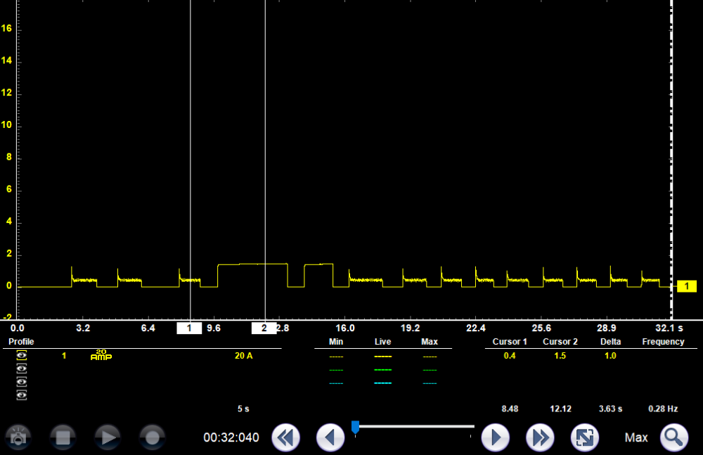

'01 F-150 4.6L, complaining that the truck wouldn't start for three days straight. Felt like starting on the fourth and immediately brought it to us. No start, no fuel pressure.
Scoping the fuel pump current with a fuel pump relay jumper installed so I can field the pump on my own. This is what I find:
I'm pretty sure the pump motor is seizing up. :huh: It's not like the brushes are worn or the motor segments are open - there's current flow every time I close the relay. I sold a pump assembly and time to investigate the tank for water/debris/sugar/whatever.
Anything I'm missing?
5 years 10 months ago #45277 by Matt T
Replied by Matt T on topic Interesting fuel pump failure
The spike followed by hash events look like the pump running and the two tall ones do look like locked rotor. It is a bit weird that once the pump gets moving it's current draw is normal.

Matt T wrote: It is a bit weird that once the pump gets moving it's current draw is normal.
Agreed. Once it gets moving, it's happy-ish. It even produces some fuel pressure! :silly:

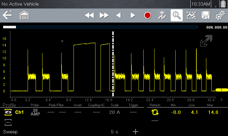

This was my screenshot:
And this is the exact same capture when viewed in ShopStream Connect:
All the current values are off by one decimal point. :blink: So all of the detail in the pump waveform is gone. If it helps, this is about the most coherent detail I could get out of it:

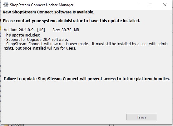

5 years 10 months ago #45290 by Matt T
Apparently there is a new version of Shopstream. If you haven't already upgraded that might fix the problem viewing Triton files. I'm installing it right now if you want to post the VSM and I'll try viewing it.

Unfortunately, I already have that version. :( And ever since the update to 20.4, the scope file formats are now .LSM.
Interestingly, the captures still have the correct scaling when viewed on the Triton itself. :huh:
5 years 10 months ago #45297 by Matt T
That 20.4 SSC software is junk. The zoom didn't work, and when I clicked Help>User Forum it launched interlink exploder :blink:
Tried opening the .lsm file in 19.? and it was scaled wrong same as in 20.4. But at least the zoom worked :cheer:

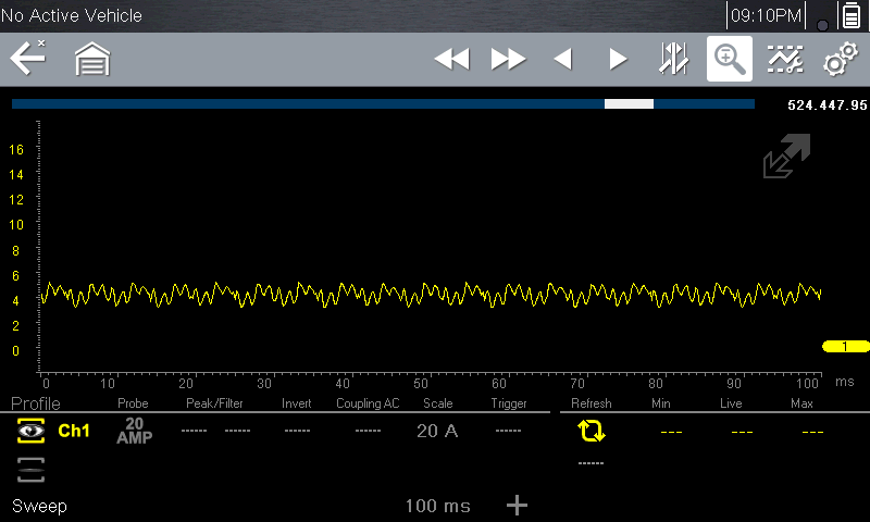

  • Tyler's Avatar Topic Author
5 years 10 months ago #45299 by Tyler
Replied by Tyler on topic Interesting fuel pump failure
Retook another shot of the pump waveform when the pump was actually turning:
