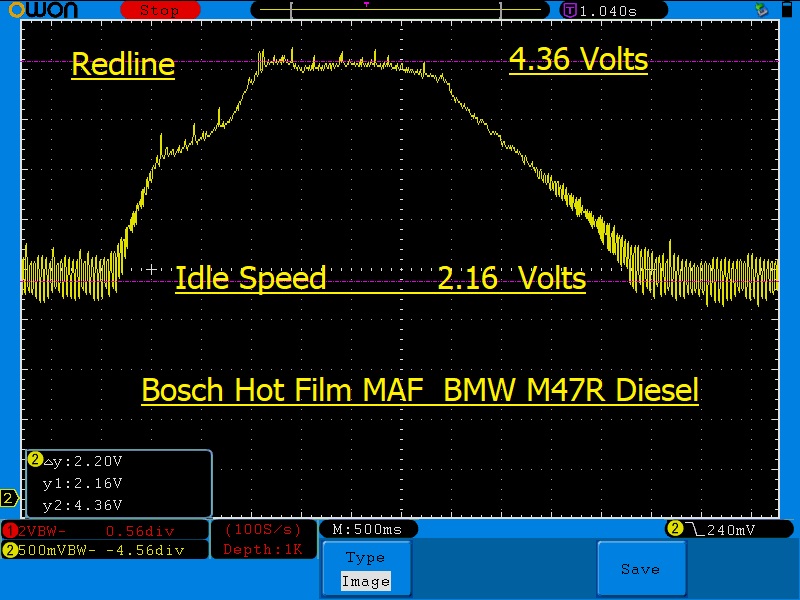

Is there a way to test the MAF? It moves up and down with throttle response but I am not sure how to test beyond that.
5 years 10 months ago - 5 years 10 months ago #45436 by Andy.MacFadyen
Replied by Andy.MacFadyen on topic Diesel Trucks?
The hot wire type are really easy to check. The voltage output on the Hot Film type can be either 0v to 5v or 0.5v to 4.5v.
The engines I see are generally Bosch CRD1 and use a Hot Film 0.5v to 4.5v sensor.
You can test these with the car stationary engine running using either a multimeter or a scope.
Connect to the signal wire by back pinning at the sensor (Bosch usually yellow wire)
At idle you should see somewhere between 1.5 to 2.1v
Hit the gas pedal and increase rpm to near the redline and the voltage should initially jump to 2.5v or so then more steadily to just over 4v.
The fall back in voltage when the pedal is released is slower than the rise.
If you are using a scope you can see hash on the scope trace which is actually single induction pulses.
I have a nice scope capture from a Freelander TD4 that I will try and look out tomorrow but the Pico guided test show it all anyway

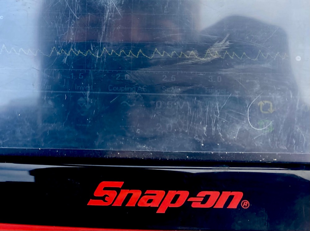

While not an injector problem, I did manage to diagnose a compression problem quickly with my lab scope. Sorry for the crappy quality photo.
