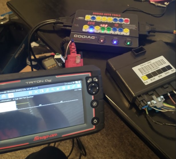

Finally got my hands on one of these last week. Gotta say, it's well worth the money! B)
Works perfectly as a BOB. Works even better when bench testing modules. The test harness it comes with has enough power/ground/CAN/network pins to connect to everything I had on hand. I tested a '13 Sentra PCM and an '04 GM BCM with no problems:

A question on bench usage, are you providing external power to the BOB, then pin out to the ECU and bringing only the ECU outputs you are interested in back into the BOB? Can you then hook up the scan tool to talk with the ECU as well as test outputs at the sockets. Would I be correct in assuming this is to eliminate any ECU inputs on the car causing it to fail (Like the DDan BMW video with the shorted handle killing the locking module that killed the car for example).

Wightscope wrote: A question on bench usage, are you providing external power to the BOB, then pin out to the ECU and bringing only the ECU outputs you are interested in back into the BOB? Can you then hook up the scan tool to talk with the ECU as well as test outputs at the sockets. Would I be correct in assuming this is to eliminate any ECU inputs on the car causing it to fail (Like the DDan BMW video with the shorted handle killing the locking module that killed the car for example).
That's a big one, sure. Another would be to do bench programming, or to verify that an EEPROM repair worked as intended

Question, what are the 12v(15) and 12v(30) switches for is that just power supply to the breakout cable from the DC converter?
Those are there to power the bench test harness with hot at all times power (15) and key on power (30). It's useful when bench programming modules that require key cycles.
