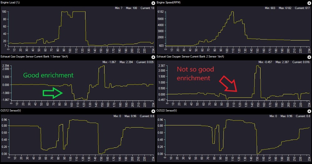

hello all, this is probably a basic question, but i can not remember from a class we attended, there is a way to check proper O2 function with a scan tool. i believe it is watching the O2 voltage during acceleration then quickly taking your foot off the accelerator. can anyone enlighten me to this? i cant remember all the pids to be watching to test this way.

Usually I'll look at the front sensor on a scan tool to make sure, with a little rpms held, that it's oscillating from at least 200mv to 800mv. You can pull a vacuum line off and see if immediately drops down to low voltage and introduce propane into the intake to see if voltage rises.
You won't really be able to judge the speed of these events on a scan tool, but these tests will give you a good idea of the sensor is responding to changes in the mixture.

My go-to quick test for A/F sensors is pretty similar to what you're describing. Wide open, get to fuel enrichment (if the car uses it), then closed throttle decelerate until the fuel cut. This forces the A/F sensor through its entire sensing range.

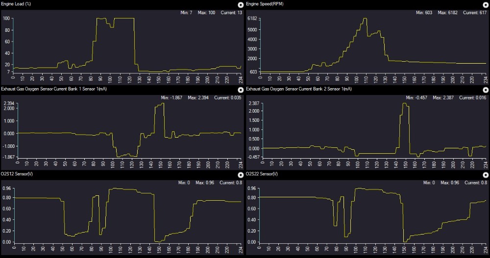

I have an example from a 2011 Edge 3.5 EcoBoost. This engine uses A/F sensors upstream (which Ford calls UEGO's), and conventional O2's downstream. This shot shows wide open acceleration through first gear and into second, then a closed throttle decel:
Ford A/F sensors show negative current flow to indicate rich, and positive current flow to indicate lean. Zero current indicates stoichiometric. I've included the downstream O2 signals as a reference.
This vehicle actually has a problem. Bank one upstream A/F goes quite rich during WOT, as most EcoBoost engine do. Bank two... doesn't. :lol: It flatlines at just under stoichiometric. However, both upstream A/F sensors achieve equal lean value during fuel cut.

A good tip for broadband sensor testing with an Autel scan tool.
Graph the broadband O2 sensor ma/current pid. Open the drop box to adjust min and max settings. Start at -300 min and +300 max then fine tune for best results.
Your graph will now show the sensor response to fuel trim changes in a very similar way to a regular sensor with a 100mv to 900mv range. Except in ma as the sensor tries to balance it's internal measuring cell.
