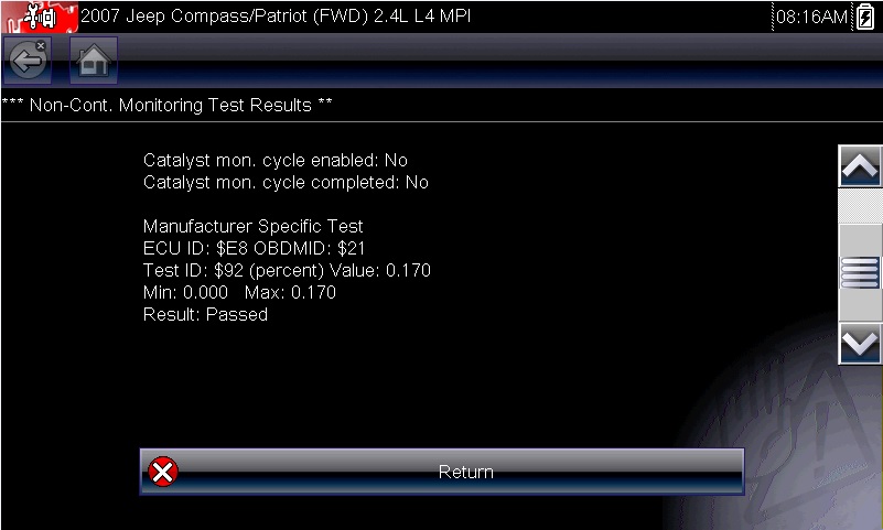

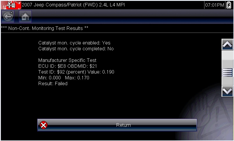

It sounds like the catalyst on bank one is on the failure borderline... Here's an example I took off an '07 Jeep Patriot. It was intermittently flagging a P0420, and this is the Mode $06 result it came in with:
Before any testing, I cleared the codes and took it for a drive. I got the catalyst monitor to run again, and this is what I found:
Catalyst, make up your mind! :angry: Are you working or not? :lol:
