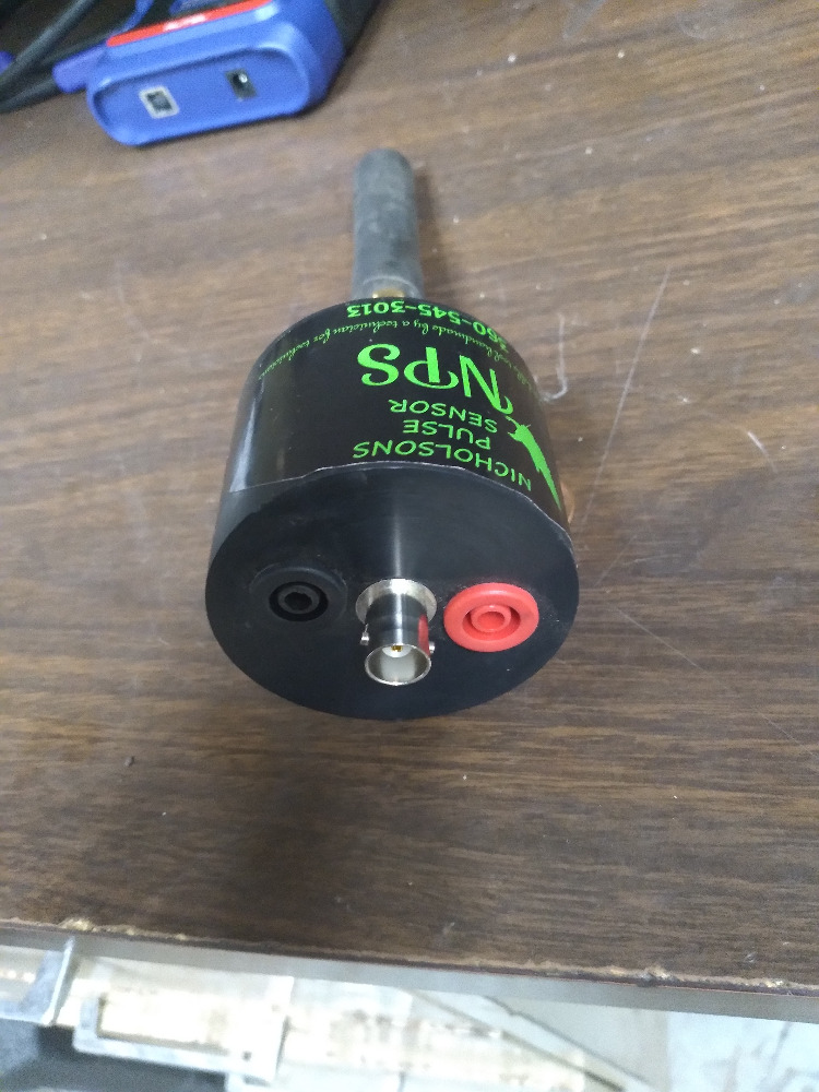

I use the Nicholson Pulse Sensor.

I don't know what the Ditex costs. But, the first pulse sensor I ever bought was a Firstlook sensor, by SenX Tech. I paid over $400, plus shipping. AESwave now sells them for $350.
A year, or so, later, I decided that I needed a second pulse sensor. I found the NPS on Facebook. The sensor AND a BNC/Banana plug cable for about $100. After using it, I bought another one. Then, I bought 2 more. Now, my poor $400 firstlook sensor, rarely, gets used. NPS is the only sensor, (that I know of) that accepts BNC AND Banana plug.
I believe, all the home built sensors listed above are of very good quality, with many people in the industry currently using them without complaint.
