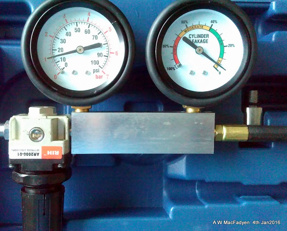

As above but personally these days I tend to go straight for a leakdown test if any cylinder is suspect, I recently bought a very low cost Bergen Tools branded leakdown tester to replace my home made one. It works at only 1 bar pressure, my old one and most older factory made ones work at 100psi. I have made a coupling up to connect it to a little 12v compressor but have yet to try it out on a bad cylinder.
Matt (SchrodingersBox) did this with an 100psi type but from his YouTube Video although worked his little compressor struggled to make enough air at 100psi.
Link I found this one on eBay UK I am pretty sure it is identical to my Bergen one but at an even cooler price got to be a bargain.

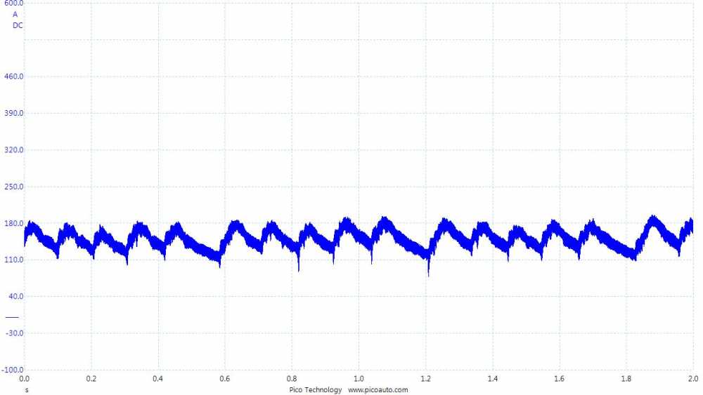

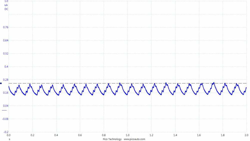

9 years 7 months ago #7526 by gav09
When most engine now say something like this for the compression specification.
"The minimum compression in any 1 cylinder should not be less than 70 percent of the highest cylinder. No cylinder should read less than 690 kPa (100 psi). For example, if the highest pressure in any 1 cylinder is 1 035 kPa (150 psi), the lowest allowable pressure for any other cylinder would be 725 kPa (105 psi). (1 035 x 70% = 725) (150 x 70% = 105)."
To me performing the test in a consistent manner is more important than whether the throttle is open or not.
I usually do a relative compression check and then jump to cylinder leak down.
For example this one falls into the 70% range
This one on the other hand not so much.

Ok here is the update on the leak downtest with a 12v tyre pump compressor.
I tried running from the car battery and battery jump start pack (the type with a lead acid motorcycle battery) without problem,
My little compressor generated enough pressure and flow for the test on a known good cylinder but the pump died in the process before I could get a picture or test it on a bad cylinder. I should say the 12v compressor was over 10 years old and was both tiny and the cheapest of the cheap. I am pretty sure one of those 2 cylinder versions advertised for 4x4 use would have been fine One thing I did discover was with the little compressor you really have to be 100% sure the air connections on the supply side are leak free.
For normal use I will stick to using it with the little mains voltage compressor.
