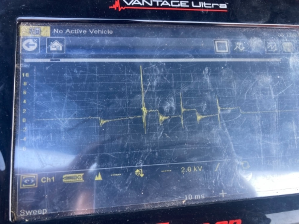

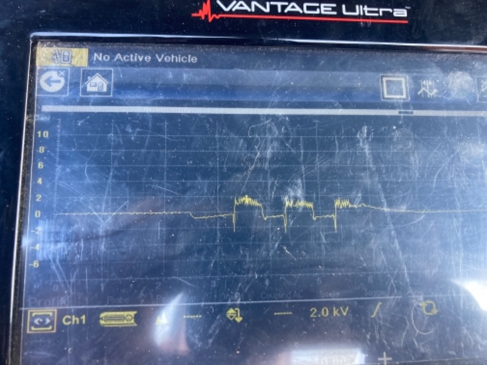

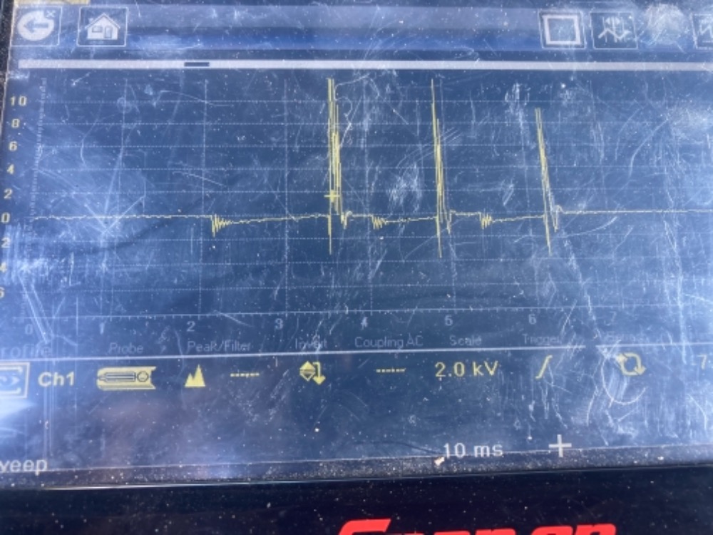

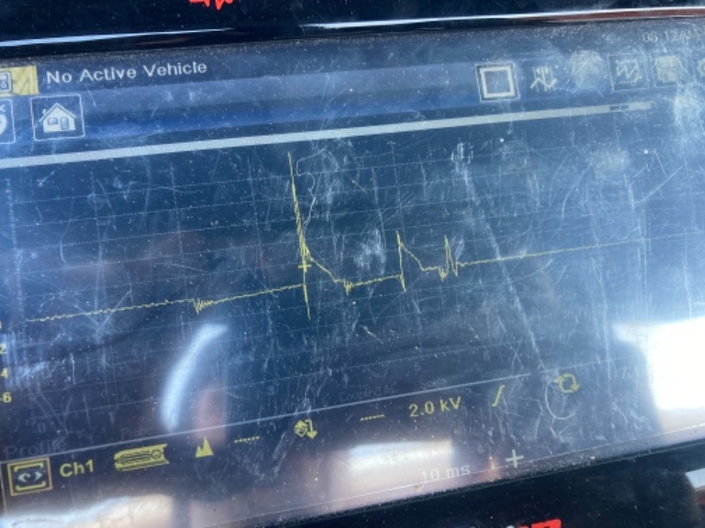

The first one to me like good, the second one has a lot of hash and concerned me, the third one has a weird ramp after the spark, and the forth one was the one that wasn’t firing at all.
These were captures of the secondary ignition waveform.

The second one is classic failed Ford ignition coil.
I'm not sure about the physics involved, but I've always associated that waveform with the spark 'ringing' in the coil instead of going across the plug. I have yet to see that particular waveform caused by a plug issue.
The third and fourth ones might be caused by the probe placement on the coil. I usually see the third one when the probe isn't on that sweet spot, and therefore the capture loses amplitude and detail. The fourth seems like more of the same. I'm really not trying to sweat you.
I've just seen the same thing doing my own secondary testing.

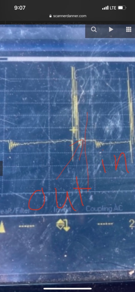

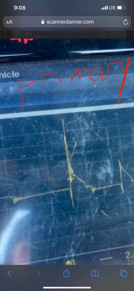

Look at the included images
Cut the burn line in half, anything in the first half is outside of the cylinder, anything on the right is inside of the cylinder. Spark wasn’t making it into the cylinder...
The weird down Ramp is a failure in the insulation on the primary winding.
