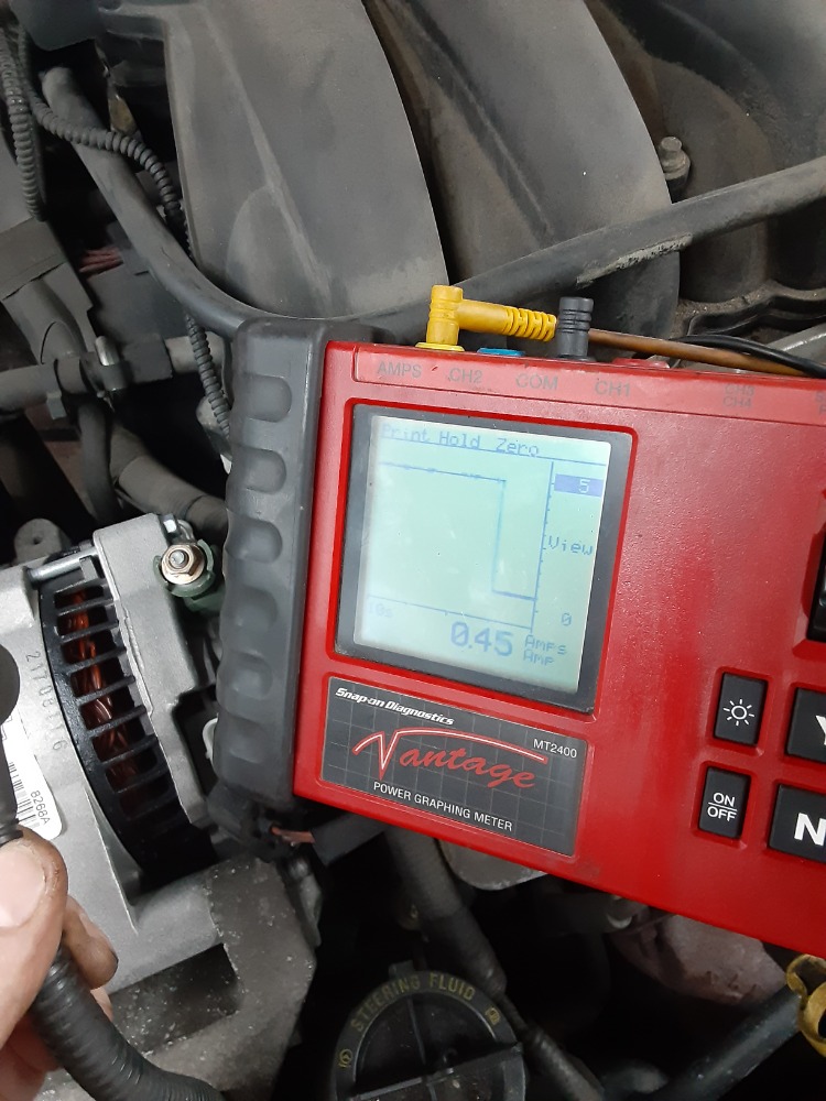

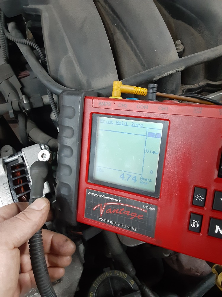

This will be quick, just wanted to share the latest key off battery draw complaint I had.
Once I was hooked up I could see there was nearly 5 amps of current!
Anything pulling that kind of load should have been obvious, but no lights were on, no motors or pumps were running, so the first test I did was disconnect the B+ cable from the new alternator:
And after about 30 minutes it fell down to about 20ma.

5 years 7 months ago #47942 by AJeep18
Replied by AJeep18 on topic Re:Key Off Draw
I’m curious if you have a theory as to what it took so long. It seems to me that as soon as you unhooked the B+ the voltage would have stopped back-feeding and the draw would have gone away?

5 years 7 months ago - 5 years 7 months ago #47956 by Noah
Replied by Noah on topic Re:Key Off Draw
It dropped 4.3 amps with the battery feed disconnected, down to 450ma.
Which did seem awful high to me, but I wasn't ready to go digging around the fuse box just yet since I knew the modules all would still be awake because I just started the draw test.
So I went after a crank no start Yukon in the parking lot while I waited for everything to time out.
And you are correct, I disconnected the control harness to ensure it was just the alternator that was the source of the draw and not some weird fault in the control circuit.
Every time I looked back at it (every 10 minutes-ish?) it stepped down consumption more than 10ma. Eventually on one of my passes by the car it had fallen to 20ma.

5 years 7 months ago #47964 by AJeep18
Oh I see, I didn't look at the picture close enough. :blush:
