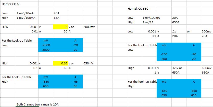

Hey all, I know this is an old topic, but I'm struggling with the pico scope set up. I thought I had it set up right, but it's not. I just want to make a custom probe for each amp clamp. So the 65amp clamp 1mv/10ma, same clamp, 1mv/100ma. The 650 clamp 1mv/100ma, 1mv/1amp. So I was told the 65 clamp (1mv/10ma) on the look up table should be -1000mv to -10ma and 6500mv to 65ma. Is this correct? I just want to get these set and not worry about it anymore. Any help would be greatly appreciated. This has been driving me crazy because I see different settings from different people and I don't know who has it right. Thank you in advance.

Replied by Paul P. on topic Hantek 65amp and 650amp clamp setup
Never stop Learning.
