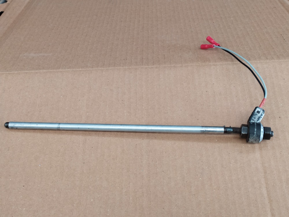

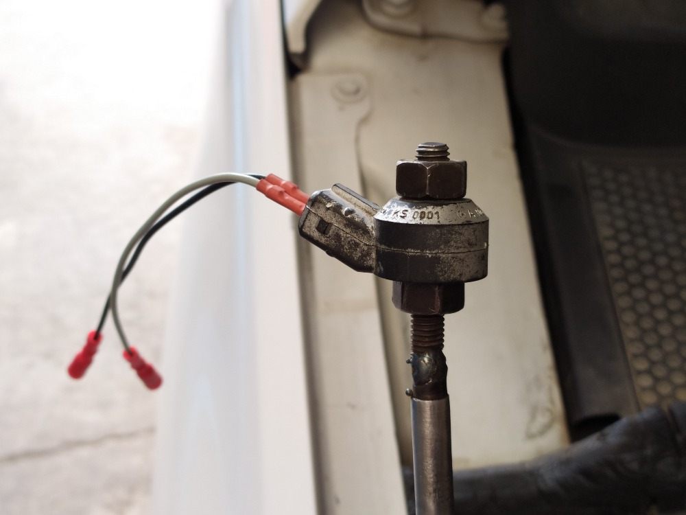

I put a bolt through the eyelet of a knocksensor. The bolt is welded to a 12 inch push rod and the sensor connects to the scope. This setup is great to capture noise, vibration, knock of many kids and frequencies. I'll upload a picture of the device later so you get an idea...
You also may take any simple piezo sensor, put it in some kind of appropriate housing and connect it to the scope, AC-coupled.
The actual pintle movement (which gives you the actual opening time of an injector) is observable by scoping voltage and amperage: If you really blow up the voltage waveform it allows even for identfying the injector opening, depends on your scope....

The sensor is from a Mercedes "A-Klasse", around 2004. It works very good over a broad frequency range. I use it for noise, vibration etc. Allows for quick ( physical) injector opening check on GDI fuel rails where the pressure sensor connector isn't easy to access (VW, AUDI 1.4 & 2.0 engines)
