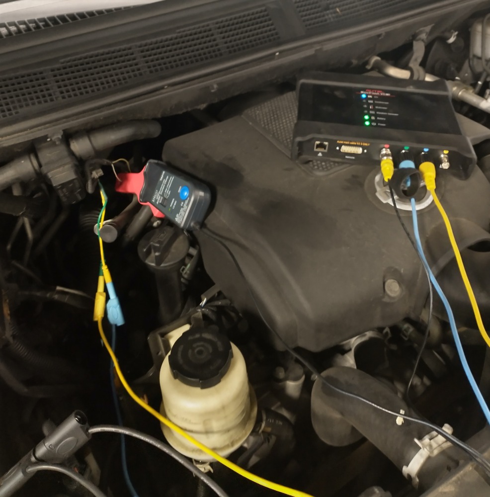

For me, the game changer has been the scope. Specifically the wireless feature. For example, I was scoping a Nissan Armada heater control valve:
Set up this way, I can sit behind the wheel while running the HVAC controls, WHILE watching the scope. B) No getting the capture going, then having to recapture it because you had a setting wrong. No flagging down another tech to run the HVAC controls while you're watching the scope. It's the same with other tests - relative compression, in-cylinder, head gasket checks. If you're rolling solo, or a helper is busy making money, this could be hugely valuable. It's still no Pico replacement, but it's darn close. ;)
