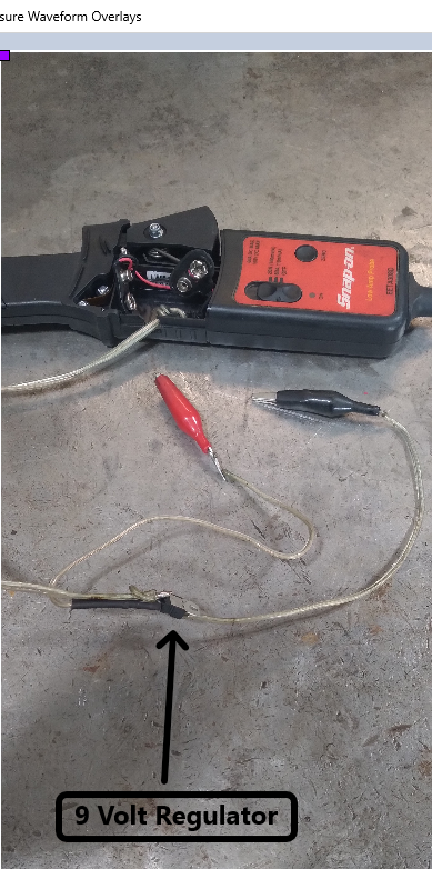

Alright I am done killing 9v battery's in this darn thing it's time to make a 12v converter housed in the battery case that will be an easy plug in and hookup to car battery when in use.... I'll update when I get it together.

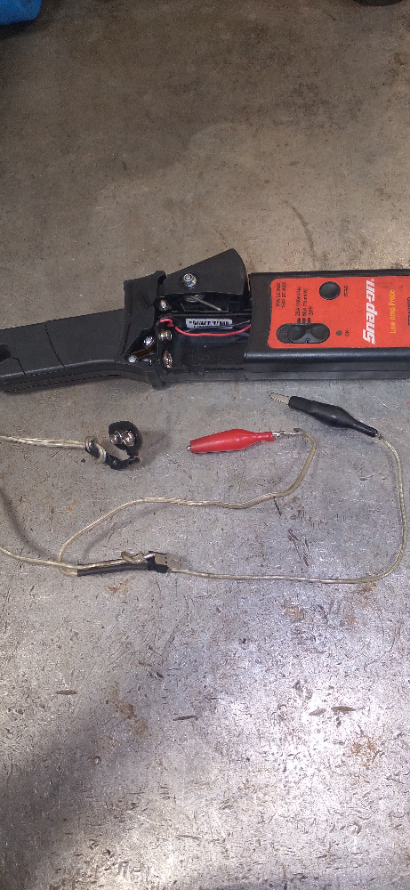

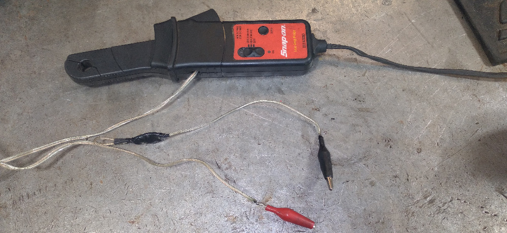

5 years 5 months ago - 5 years 5 months ago #49035 by Chad
Frustration got me, too. So, I use a 9 volt regulator, and connect to the car battery.

5 years 5 months ago #49036 by Ben
Rechargeable isn't a bad idea but I think I'm ready to just hardwire it... I wish it had an auto shutoff feature like every other batter tool.....

5 years 5 months ago #49037 by Ben
What's your regulator setup look like chad?
5 years 5 months ago #49039 by Chad
Ben wrote: What's your regulator setup look like chad?

5 years 5 months ago #49041 by Ben
I had to open it on the website to see the picture which I then seen you already posted the picture.... sorry about that I pretty much hate this app it's just way easier to navigate on my phone....
