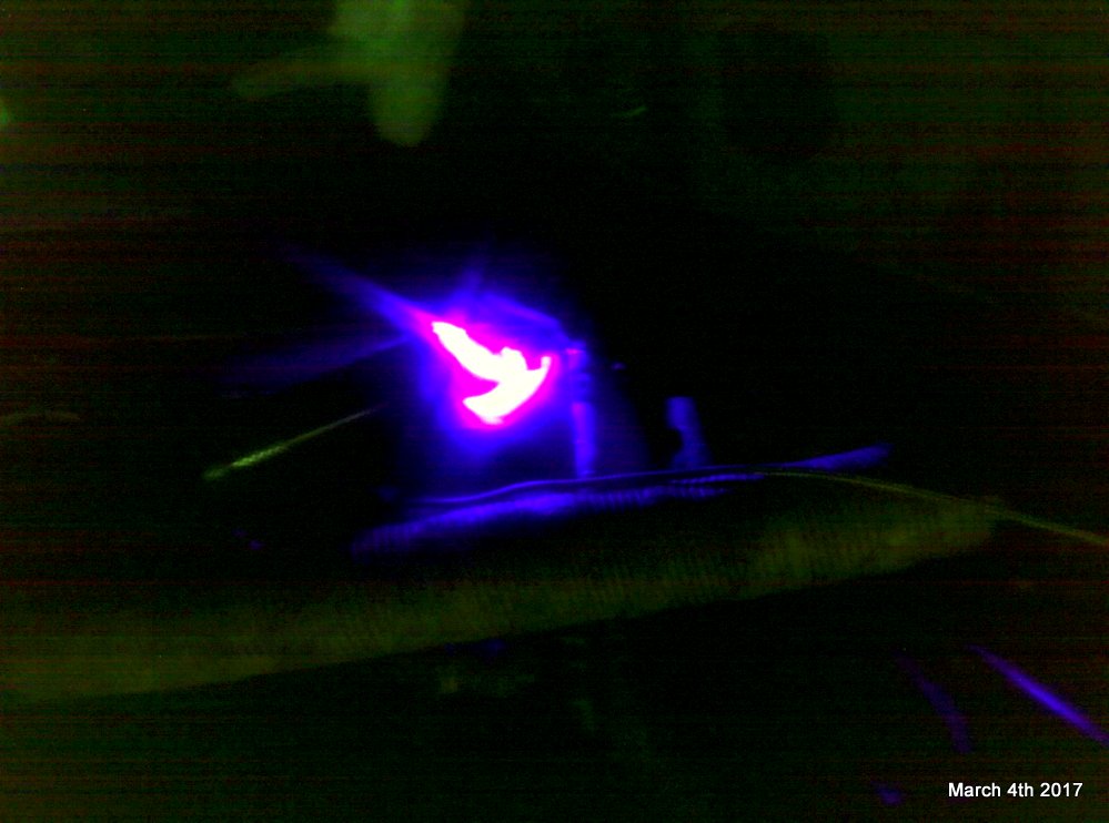

Coolant leak, vehicle had never required a coolant top up in two years suddenly lost about 2 litres/quarts after a 100 mile journey.
No obvious signs of leakage cold and hot pressure test revealed nothing, vacuum test was okay. Head gasket was suspected as a last test I tried fluorescent UV dye B) :) :evil:
Here is what the torch showed, a leaking cylinder head bleed hose at the rad -- game, set and match.
9 years 7 months ago #6692 by Tyler
Replied by Tyler on topic Don't forget how useful UV dyes are.
Boom! That's the kind of picture you can take to the customer. B)
