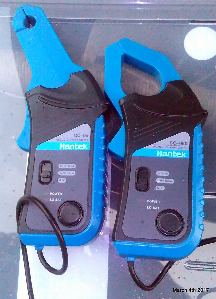

can a HANTEK cc65 amp current work on a battery posts for the purpose for relative compression test

On the battery lead yes I have 1 and it works well

Replied by Andy.MacFadyen on topic CC 65 A CLAMP FOR RELATIVE COMPRESSION TEST
No a CC65 won't do relative compressions the current range is too low and it won't go over a main battery cable, a CC650
is the Hantek DC amp clamp for cranking current.
I wouldn't recommend either Hantek is the cheapest of the cheap lots of other DC clamps available.
A low range clamp is a better first buy as without a high range clamp you can do relative compressions by scoping the voltage across the battery, the humps for each cylinder are just inverted ie a higher voltage hump = low compression cylinder.

If all you want it for is relative compression then it wouldn't hurt to get the 650 to do diesel as well. but the 65 will do everything from Injector current to relative compression

Sorry Andy my network is junk and it didn't load your whole message which is mostly right except that it can be done with the cc65 I'll post a shot of it later
