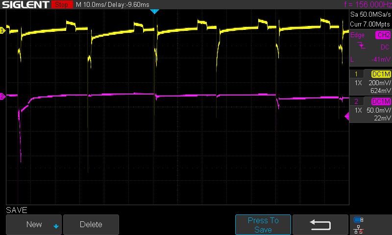

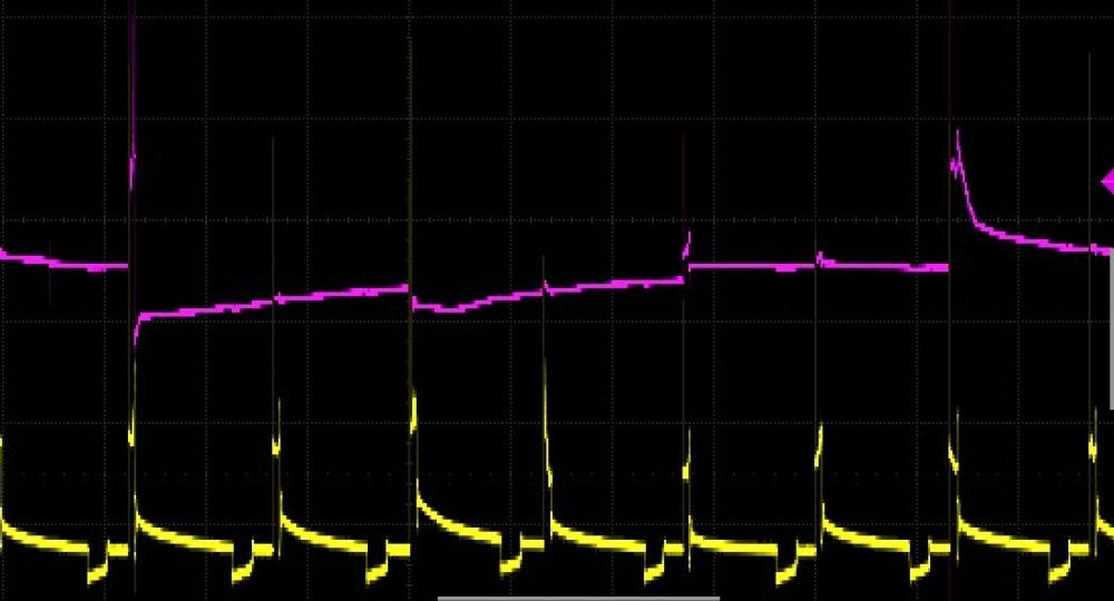

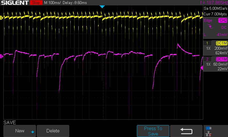

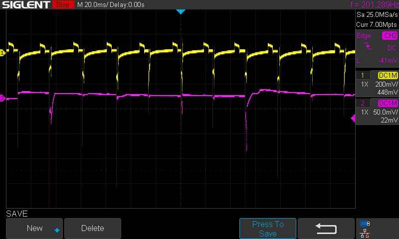

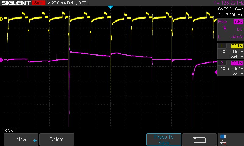

I've watched Eric O. on YouTube use wave form diagnostics to pinpoint a problem.. I was hoping I could too. I just bought a brand new digital storage o'scope (really for electronics work, not automotive) but since I have two inductive pickup probes.. i figured why not. I've looked at these screen shots, but with no idea what I'm looking at.. the only thing that jumps out at me, is the #4 pulse is much shorter than the rest...
background: this is a 1994 CPI 4.3L. I changed the spider injector, it ran like a swiss watch. I drove it 10 minutes to lunch, shut it off.. had lunch.. came back to a crazy hard start, and when it did run, a very noticeable hard miss. I would suspect it's the same cylinder every time because it's a very steady, rythmic miss.. it's not spitting and sputtering.
in the images, purple trace is the #1 cylinder. yellow is from the ignition coil. firing order is 1-6-5-4-3-2

For our reference, was the miss taking place during your capture?

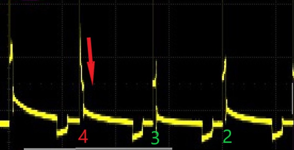

I'm not sure if your scope has an invert function or not, so I took one of your images and rotated/inverted for ease of viewing:
I would agree with your suspicions about #4. It's not the burn time that bothers me, but the sharp downward slope of the burn line. I usually see that kind of slope related to a short in the secondary circuit. Carbon track, coolant in the cylinder, like that.

yes, the miss was present during these captures.
I'm not sure what you mean by the sharp downward slope.. as far as I can tell the only difference I see with #4 is short peak.
edit:
i went back and looked at the pics I have... i think i understand what you are referring to now..
i marked on this pic what I think you are talking about.

As an idea for your next round of testing, you could use one pickup on the #4 and the other on another cylinder. Preferably #5 or #3, as they're adjacent in the firing order, and make for easier captures. You'll lose some detail not being on the coil wire, but you'll be able to get very comparable readings from a suspected bad and a suspected good cylinder.

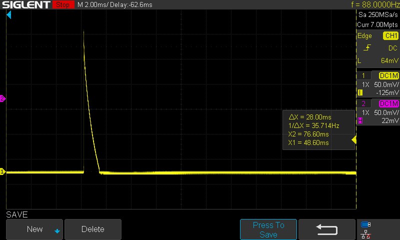

well, I did part of this.. I did put the coil pickup directly on the #4 wire. for some reason it didn't save everything.. not sure why.
but I did get this one shot.
