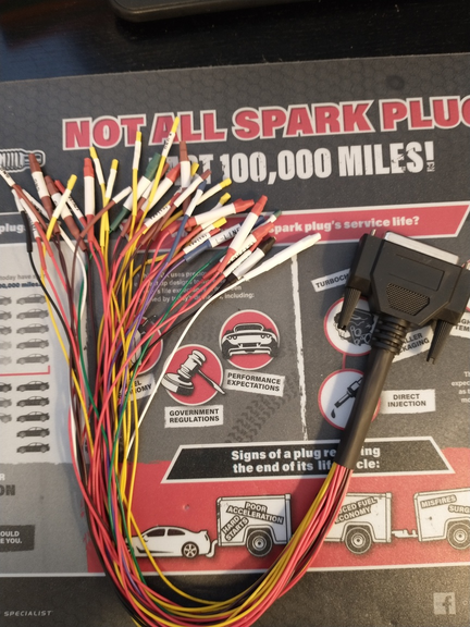

Like the GT100, the GT100+ comes with a breakout harness for supplying power, ground and communication to a module:
I know, it looks like a disaster. :silly: But it's actually pretty easy to get a module hooked up once you get familiar. Each pin is clearly labeled, and there's usually enough powers/grounds to most anything you're gonna connect to. Only really needy modules (think GM BCMs) require additional pins. The pins themselves come in two varieties, and work perfectly for connecting up to the common sizes of male pins you find on modules.

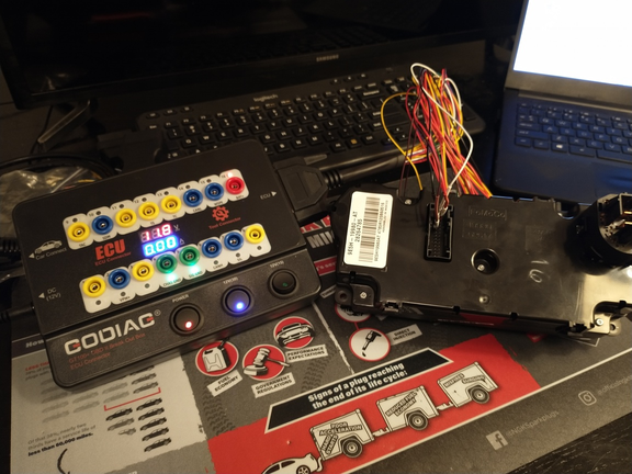

As an example, I've got a Ford manual HVAC module on the operating table. One power, one ground, two MS-CAN lines. No problem for the GT100+:

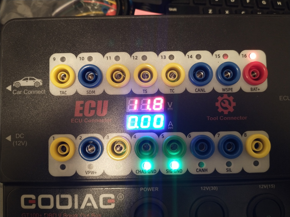

But am I connected correctly? All my pins are there, but it's not drawing any current.

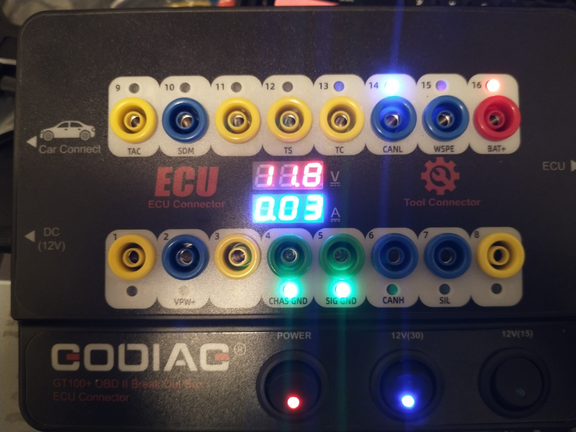

Whoops, counted one pin too far! Let's try again:
Now I know I got it right.
The module is now drawing 30mA. That's the value of the ammeter - confidence in your setup. If you're not drawing current, recheck your connections. If you're positive you're connected correctly, then the module itself is suspect.

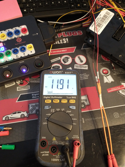

So how accurate is the voltmeter and ammeter? I checked the indicated voltage against my Owon B35T+:

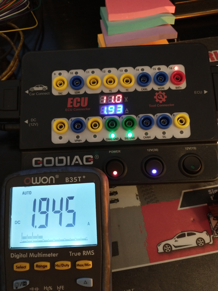

Surprisingly accurate. Then I checked current draw with a 7442NA bulb to put a bit of load on the internals:

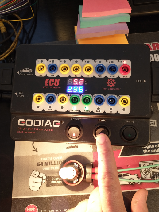

Close enough for me! That then begs the question, how much current can the GT100+ supply? It's not stated in the user manual, but the engineers tell me 3.0A:
I'm no engineer, but that sure sounds like a PTC thermistor to me. :silly: But let's put it to the test. I connected up an H9 headlight in place of the 7442. The in-rush current will exceed 3.0A.
I couldn't catch it on camera, but the whole interface goes dead when first connected. After a few seconds, the GT100+ recovers and does its level best to light the bulb. The voltage reading backs up my PTC thermistor theory. I repeated this several times just to see if I could let the smoke out. Couldn't kill it! 100% knuckledragging ape-proof.

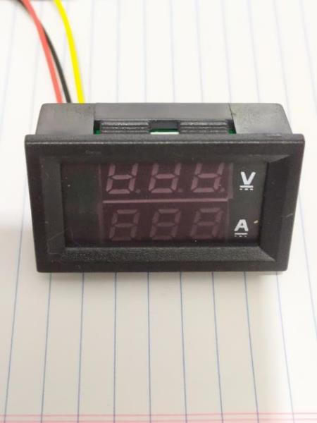

For those of us who already own the original GT 100 you can externally wire in this type of volt/ampmeter or swap it with the original one. These meters are CHEAP.
