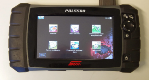

Hi guys (from France
I have a question for you as here, in Europe, Snap-On tools are not very known.
By the way, they are distributed by "sun diagnostic" brand in uk.
I already own some scanners and scopes tools and I have the opportunity to buy a "SUN PDL 5500" that seems to be very close to the Modis Edge.
My question is about the subscription : will the tool be still running for years without subscription ?
Of course, it won't be up to date and some online functions will not work but all the scanning functions (not only EOBD) and scope will still be ok ?
That is a concern as the subscription is not cheap (about 50-60 $ /month) and I should already pay the subscription for my other tools...
Nevertheless, it will be a new tool for me to add some capabilities to success in diags
Thanks.

Update : the PDL 5500 is likely more a MODIS Ultra

I have no experience with the European versions? So I honestly can't say. :blush: I didn't even know Snappy stuff got rebranded until I read this thread. But a quick Google search showed this:
That's totally a Modis Ultra. :lol: Learn new stuff every day!
But, my wild guess would be that the European versions would play by the same rules as North America. 21.4 is the latest software version available here, and the Sun website agrees. Basically, I think you're good to go.
Replied by Tyler on topic Snap On diag without subscription
Is it true for all snap-on diag tools ? even European ones from SUN ?
