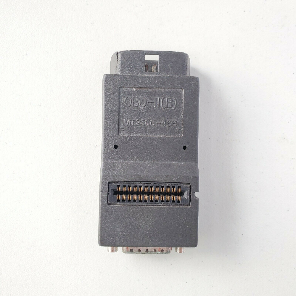

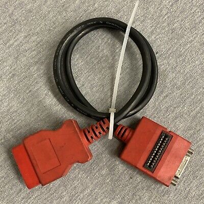

Hello all, I am new user and a newbie to higher grade diagnostic too. Please be gentle to me if my question is already answered or it's not so good of a question. I bought a used Modis that didn't have any accessory. So I am buying an personality key adapter for it.
According to the Snap-on site, www1.snapon.com/display/1068/Upgrade-162/MODISAccessories.pdf , the official adapter is EAA0355L46C. Here's a picture of it:

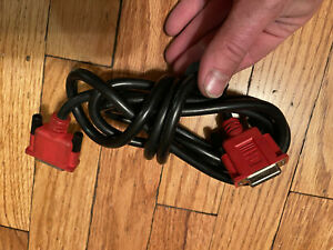

The adapter cable is short, so I suppose the main cable will extend it, and the part number is EAX0066L50A:
My question is this, would the MT2500-46B adapter together with the main cable work with the Modis, and how well does it work comparing to the EAA0355L46C?
I am sure most people here would know this newbie question. Thank you in advance!

I would like to update the post that after trying both adapters out, both appears to work equally on a car I was testing out. I was able to read all the codes, and performed crankshaft sensor relearn procedure on both.

Both cables are the same work with no major difference from those adaptors. You don't face the problem if you use this EAA0355L46C adaptor.
