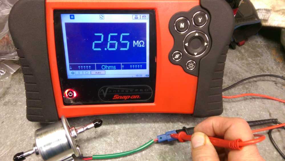

Are you sure this thing is actually a pump, and not some sort of switch? Can you take a picture of your ohm test through it? 2 Mohms+ is too high of a resistance to really perform any sort of substantial electrical work, which makes me doubt this thing is doing anything other than potentially signalling something or acting as a pull down switch. This is kinda of weird.

SniperDan wrote: Are you sure this thing is actually a pump, and not some sort of switch? Can you take a picture of your ohm test through it? 2 Mohms+ is too high of a resistance to really perform any sort of substantial electrical work, which makes me doubt this thing is doing anything other than potentially signalling something or acting as a pull down switch. This is kinda of weird.
It is most definitely 100% a pump. No question. There are two pumps on the tractor, this one is known as the "feed" or "lift" pump. It is closest to the fuel tank. When I get out in the garage in a bit I will take a pic of the ohms test.

Sniper Dan, attached is the image of the ohm test.
9 years 7 months ago #7768 by Andy.MacFadyen
Replied by Andy.MacFadyen on topic Ohms & Continuity Question
Have you tried reversing the test leads? the pump may have a built in protective diode.

Andy.MacFadyen wrote: Have you tried reversing the test leads? the pump may have a built in protective diode.
This is exactly what I was thinking!!!
I did not. I will try that in a bit. Just assumed that switching the leads would do nothing more than change the polarity of the reading. I'll get back to you. Thanks Andy.

Andy and Sniper, when I reverse the test leads nothing happens. Just get the "up arrows" on the Vantage Pro screen. No flash of the screen or anything, just acts like I'm not doing anything at all. It is set on auto so it's not a matter of not having the meter set high enough. Same result both measuring ohms and checking continuity.
