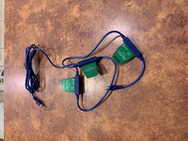

4 years 11 months ago #52915 by Mechanic 350
Here’s what I have Tyler. I never used it. It belongs to my old modis. Will it work if I use it for my vantage pro?

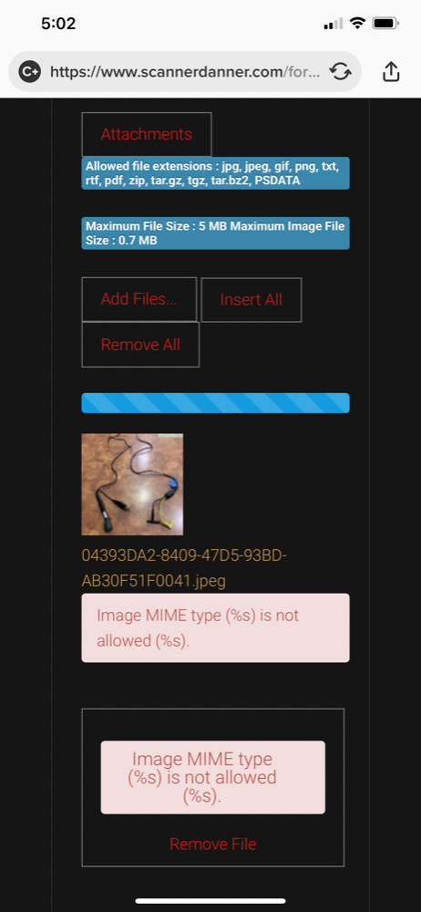

4 years 11 months ago #52917 by Mechanic 350
Tyler the website is not allowing me to show you the tools. I can’t upload the pictures

4 years 11 months ago #52918 by Mechanic 350
This is what I’m getting

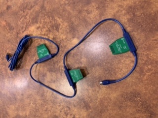

4 years 11 months ago #52920 by Mechanic 350
Pic # 2

4 years 11 months ago #52921 by Mechanic 350
Pic 1

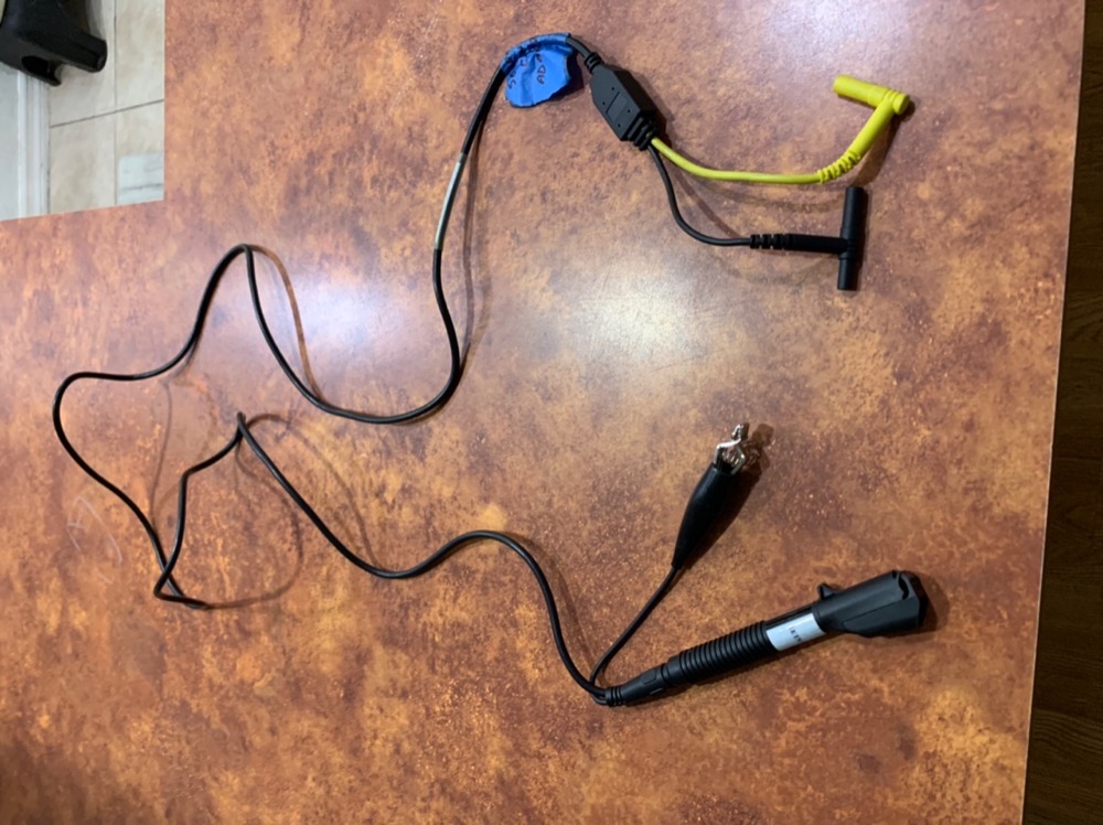

4 years 11 months ago #52922 by Mechanic 350
Pic 3
This is what I have. Will it work?
4 years 11 months ago #52923 by Tyler
Pic #3 is designed to work with ignition wires. Probably won't generate a useable waveform? No harm in trying it anyway.
The other COP flags may of be of use, though. You'd have to add a couple of these to look at all eight cylinders:
shop.snapon.com/product/VERUS-PRO-Access...-Adaptor/EAC0056L00A
You can also look at these COP 'sticks':
shop.snapon.com/product/Multi-Cylinder-S...-Adaptor/EAC0056L03A
Lastly, you'd need this kit, specifically the banana jack to RCA adapter:
shop.snapon.com/product/Secondary-Igniti...Lead-Kit/EAK0294B09A
