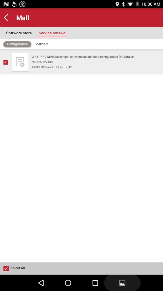

4 years 9 months ago #53718 by Tyler
Had a look at the Mall today. I explored all menus, and only found this option available:
$599. :ohmy: Almost the cost of the tool. I think I'll let this one lapse for now.

So if I understand correctly yours has all of the features listed in my previous reply free?
4 years 9 months ago #53722 by Tyler
I think so? :huh: I've never seen a prompt in the tool that said, "Hey, you want to do *really cool* button pressing? Pay $XXX and we'll let you!"
They may have changed that with newer generations of the same tool. In the case of the Pro Mini, I can say confidently that the hardware/tablet shown in that link you posted is not the same as the hardware/tablet I own. It's been updated since I bought mine.
