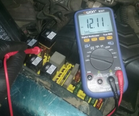

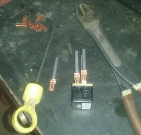

I made something! Please don't burn down your car or home.
And, obviously, don't spread female terminals.
9 years 7 months ago #7787 by SniperDan
Replied by SniperDan on topic Relay Stilts
These would be great for the odd ball relays my relay testing tools won't fit. I like the "Don't burn your house down" warning lol!

9 years 7 months ago #7791 by Tyler
Replied by Tyler on topic Relay Stilts
Instructions unclear, burned down my city block. :silly:
Seriously, though, I love this! And I recognize that meter. B)

9 years 7 months ago #7796 by Tyler
SniperDan wrote: But i'm totally making a set tomorrow ;)
I wanna do the same! :lol: What we need to know is which dipsticks correspond to which size of relay female terminals. That Chrysler trans dipstick seemed to work well for the larger blades, but what about the GM mini relays?

9 years 7 months ago #7800 by Noah
Replied by Noah on topic Relay Stilts
Good eye, points for you!
Haven't made a set for that size yet, but I've got some ideas.
The female ends are out of an under hood fuse/relay box. Maybe a Cobalt?
I know it was one of those crappy ones with the long bolts that sandwich the layers together.

9 years 7 months ago #7806 by Noah
SniperDan wrote: This is the tool I usually use, and covers the smaller gm and ford relays well. www.tooldiscounter.com/ItemDisplay.cfm?l...y68J9sqccRoCP2Dw_wcB
Where I run into problems is testing oddball japanese or euro relays, but generally they are always the large pin style so these stilts would work flawlessly for them, so long as there was room to get them in anyways
That's exactly the set I'm trying to avoid having to buy! One of the guys at the shop just bought that same set with Mac Tools rebadge and paid $300!
I think I have some toggle switches I could plug into the tops instead of the relay if need be...
9 years 7 months ago #7812 by Tyler
Replied by Tyler on topic Re:Relay Stilts
Noah wrote: "How did you get the smoke in the gas tank? Pump it in and screw the cap on real quick?"
Bwahahahaha :lol:
I was thinking about the metal inserts in wiper blades for the smaller terminals - too flexible? Just thinking out loud.
9 years 7 months ago #7813 by SniperDan
Replied by SniperDan on topic Re:Relay Stilts
Bwahahahaha :lol:
Ooooh, smart man. Those might be just the right size. I think they would work fine given they would be pretty short, and not really put under a lot of stress.

9 years 7 months ago #7814 by SniperDan
Im sure you could also insulate most of the exposed metal portion to eliminate short circuit risk with heatshrink, and just leave a small area uninsulated for a test location and obviously the points that connect to the relay and fuse box
~W. Edwards Deming
9 years 7 months ago #7818 by Noah
Replied by Noah on topic Re:Relay Stilts
SniperDan wrote: Im sure you could also insulate most of the exposed metal portion to eliminate short circuit risk with heatshrink, and just leave a small area uninsulated for a test location and obviously the points that connect to the relay and fuse box
I was thinking about that, I have some heat shrink tubing that's too large for most of the wire repair I do.
I also like Tyler's idea with the wiper blades, I'll try it tomorrow if I can squeeze in a break.
