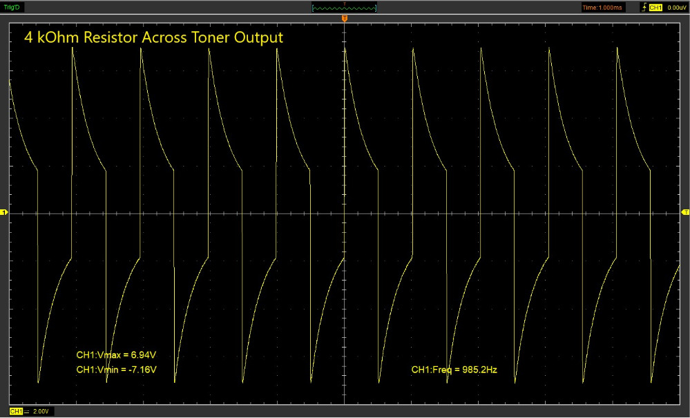

i used a tone generator like the phone guys use for tracing wires. put it on continuity setting which puts out straight dc, and it said like 8 volts. switched it to tone mode, which is an ac signal, and it showed an ac voltage reading of like 2.5 volts and the graph showed the min max of the ac reading, not the ac waveform. kinda hard to explain. but it is pretty neat. makes me wonder what other special setting there are hidden in the component test section.

You made me 'scope the damn thing :silly:
Replied by Matt T on topic snap on graphing meter hidden measurement option
