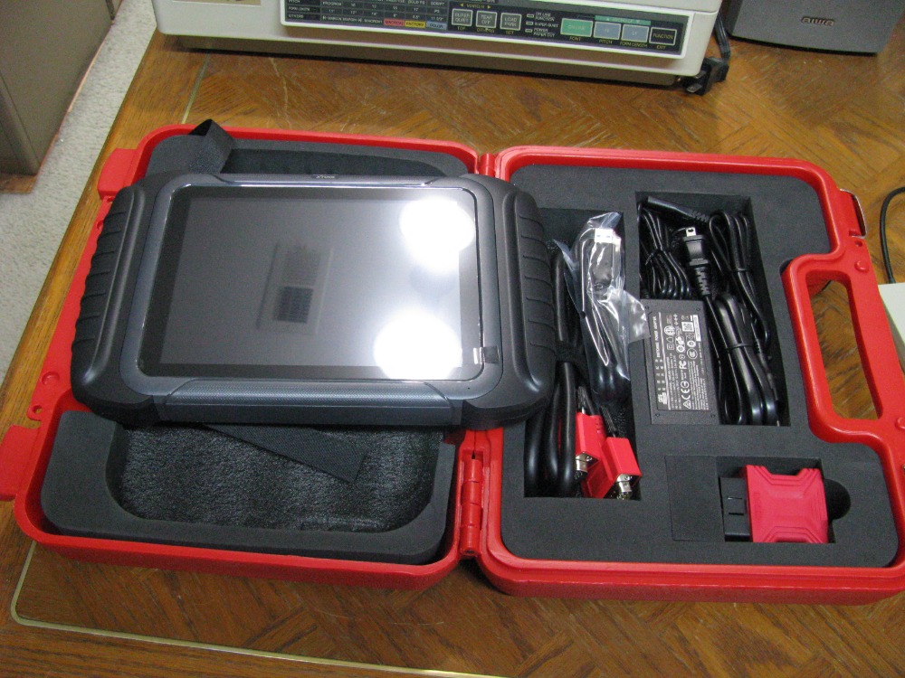

I took the plunge and bought a 'big boy' scan tool. I needed something with bidirectional control and that could reset the BMW/Mini VANOS adaptations and from the reviews I saw/read it seemed like the D8 was a lot of bang for the buck. It also has the ability to do key programming for a lot of cars and I'm told that with a FOB reader (another $250) it can do even more like the BMW/Mini, Toyota, etc.
It just arrived today, and it is 24F outside with snow and ice falling from the sky. I'll have to wait until this weekend to play with it. What has impressed me most so far was the level of communication from the company. I emailed them to ask if it had the capability to reset the adaptation for the VANOS system and got a reply in less than a day with some information. The lady who responded asked for the VIN so she could make sure there would be no issues and the next day sent more detailed information. When I asked about the BMW/Mini fob programming she pointed me to the FOB reader on Amazon and also told me that Amazon should have new stock Saturday and she would email me when it was available again. I was impressed to get that level of support these days considering I'm a nobody, shade tree mechanic asking for presales support from a Chinese company.
I'll give it a whirl and report back. I'm still undecided about the FOB reader but I would not have much more in it than getting a new FOB/key cut at the dealer. I should be able to cut the key myself as well with some more research into how they are coded (I have done this with Ford chipped keys.)

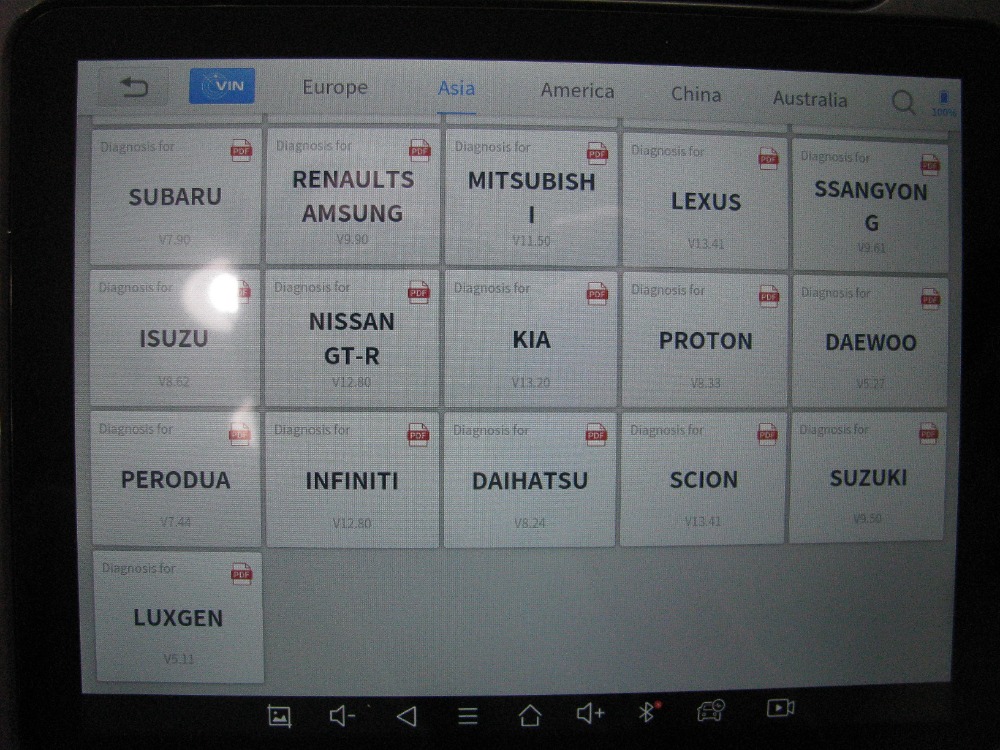

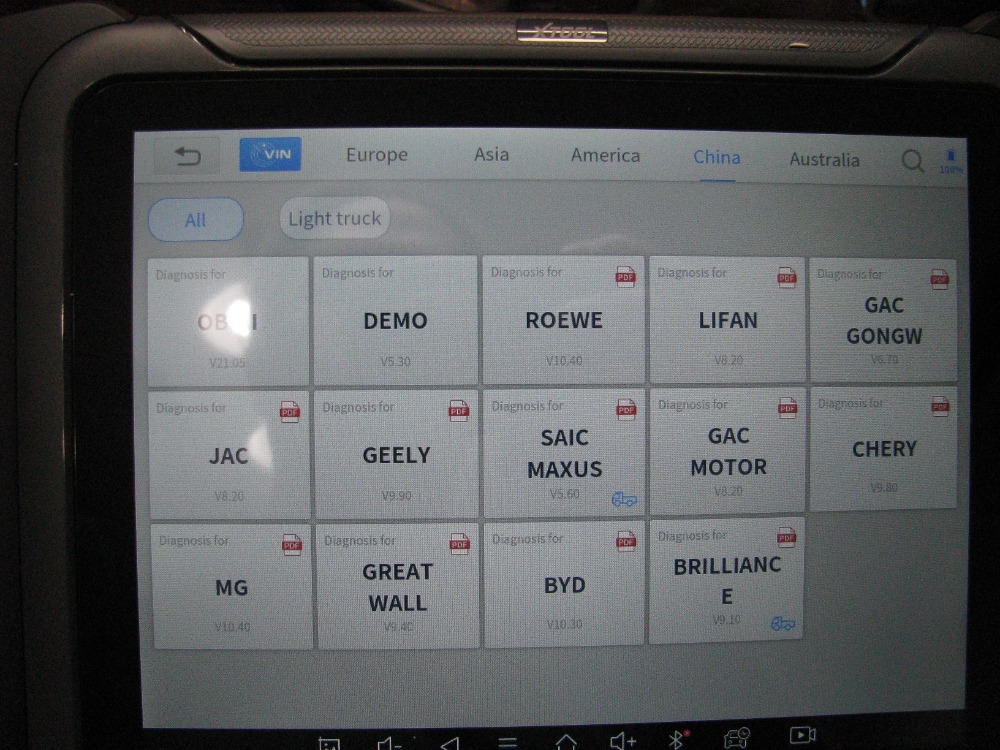

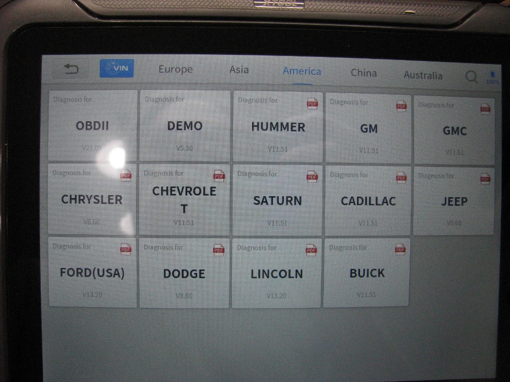

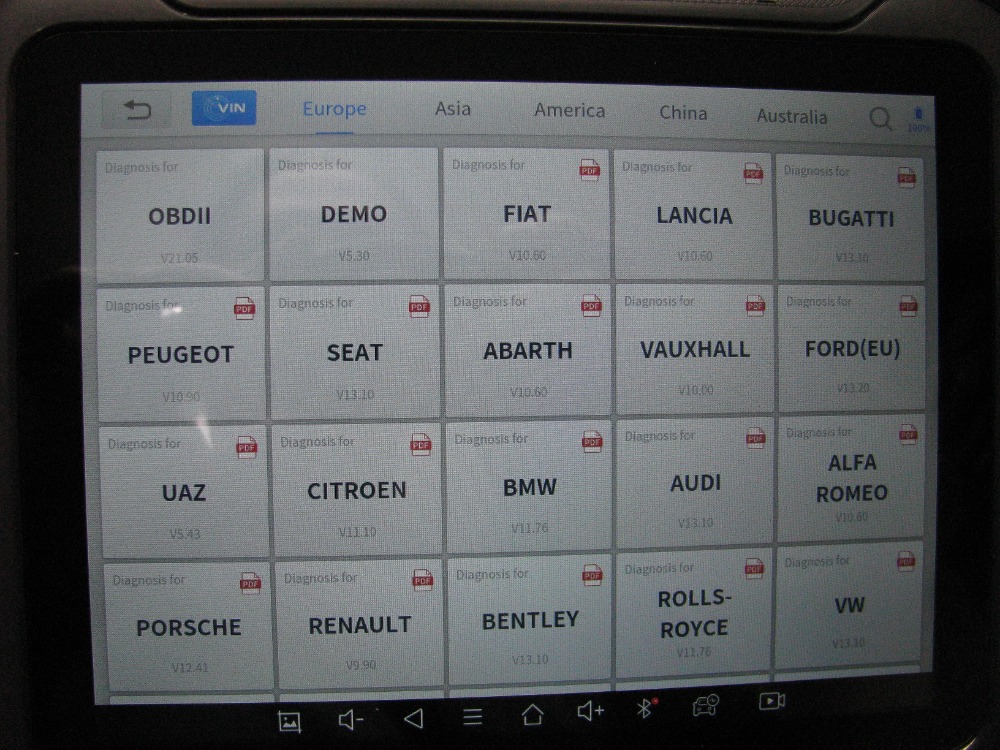

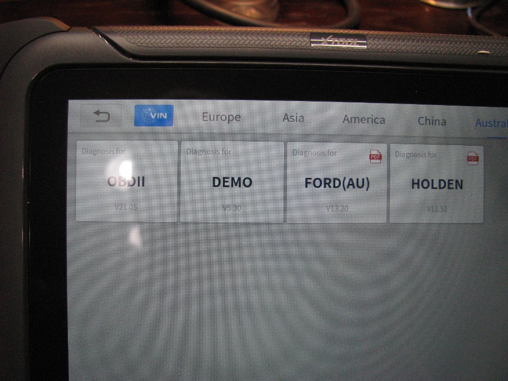

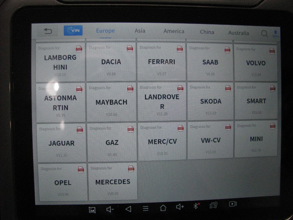

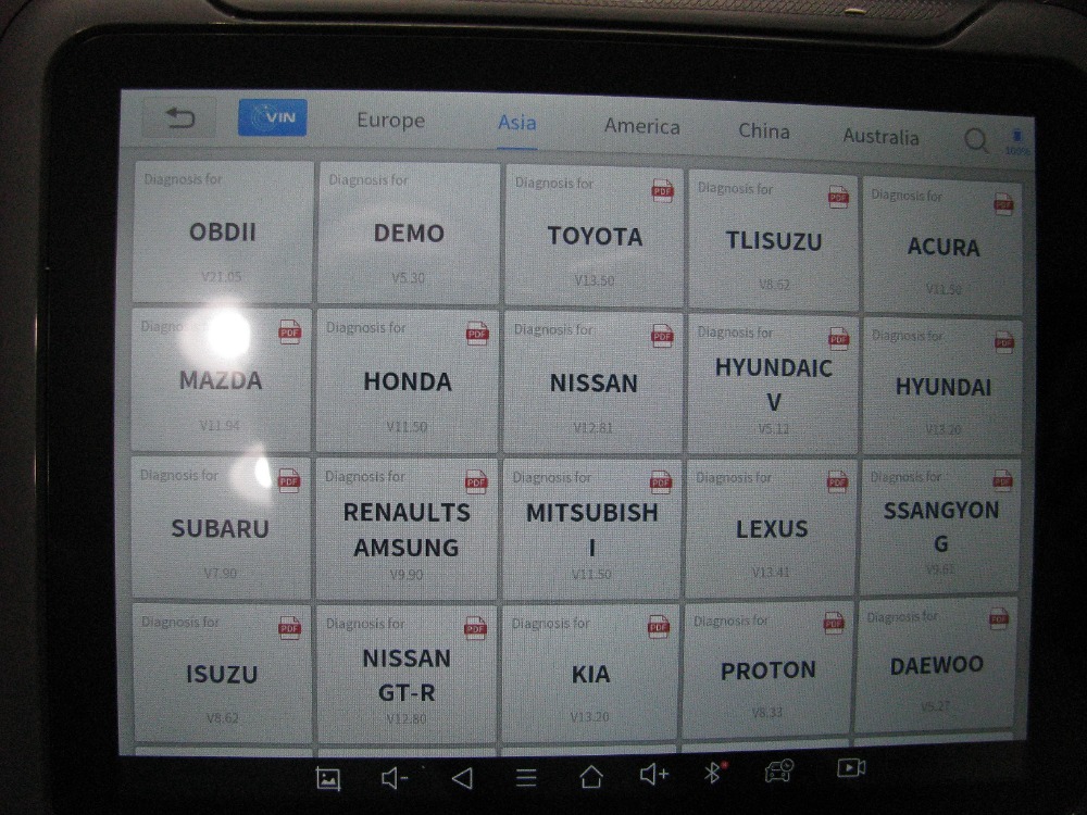

Would be interesting to see screen shot of the manufacturer selection screen,

4 years 8 months ago - 4 years 8 months ago #54455
Replied by Andy.MacFadyen on topic My first bidirectional scan tool! XTOOLS D8
