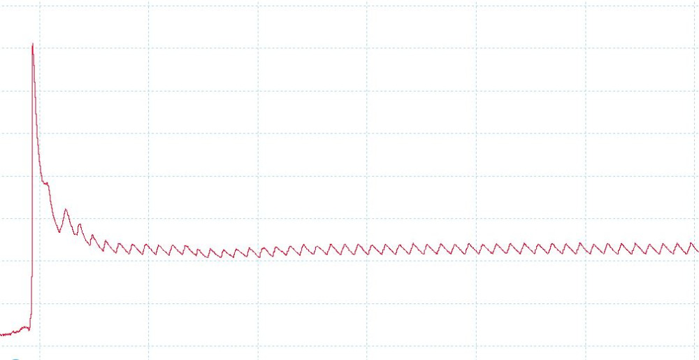

Here is a Relative Compression Waveform. Looking at this waveform, by itself, it is impossible to tell how many cylinders this engine has, let alone which cylinder is which.

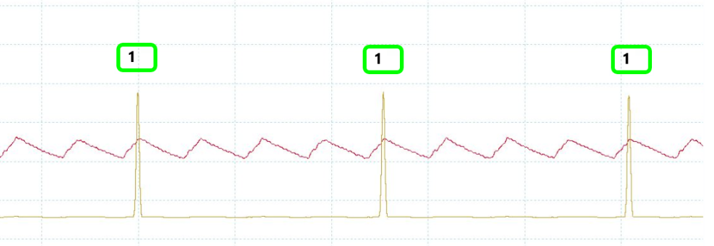

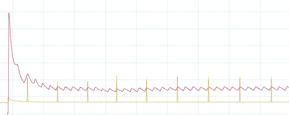

If we add a second yellow channel for an ignition strike on cylinder #1, we can now see that this is a 4-cylinder engine, with #1 spark plug firing in yellow.

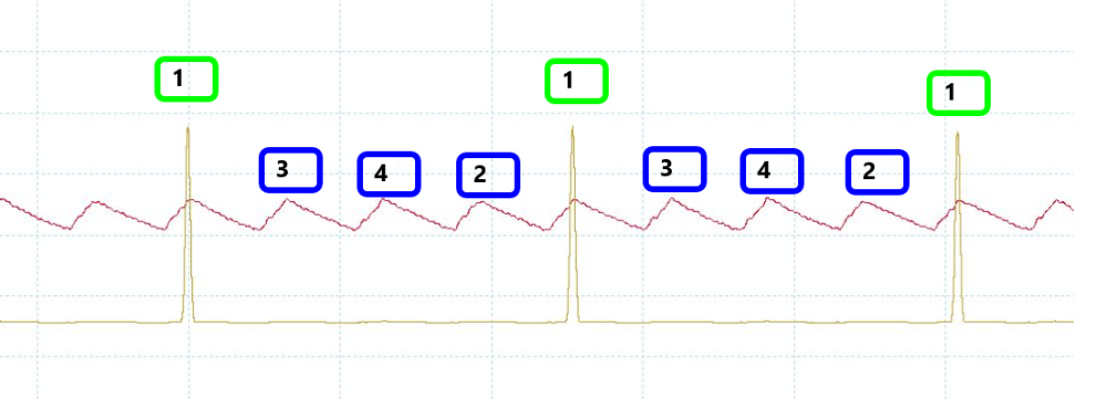

Now, all we have to do is plug in the firing order to identify the other cylinders.
