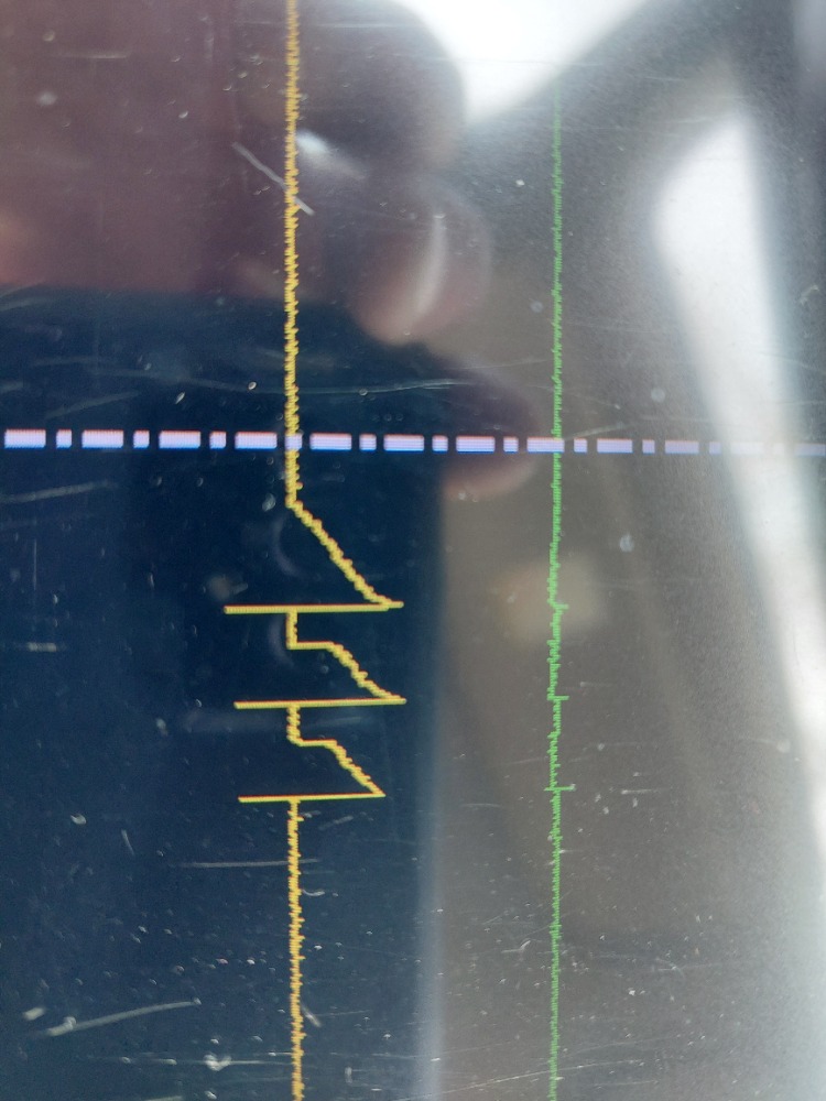

This is a COP fire on green and no.1 on yellow. I know it doesn't look right. Maybe someone can tell me something to change. I have the amp clamp on 1 volt. I should see 8 pronounced fire spikes on that green pattern. The vehicle type is a 02 Ford E350 with a 5.4 Triton. I am on the fuse block (passenger) on the 30 A that is suppossed to be for the COP on this vehicle. The fuse block is different than a F150 of same period.

Have a successful test, but engine ran decent. May need to repeat on a fully hot 30 mile drive. This screen image happened on my problem cylinders with the misfire. What does that downward spike tell you?
2 years 7 months ago #65158
Replied by Noah on topic Verus how to save oscilloscope file
Just looks like ignition related noise to me, not an indication of a fault.
They always happen right when the ramp stops, that's right when the spark takes place, so at least to me, it seems logical that you might pick up some noise in that portion of the waveform.
