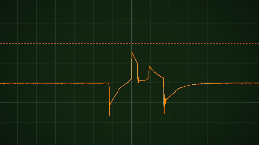

I am new here. Please could someone explain this waveform I captured at idle. using autel signal probe COP .My first time see a secondary waveform like this with two events

Ford, Lincoln, Mercury (and many Mazda by extension) engines fire COPs up to 3 times while firing at idle.

So , Can you measure the KV and burning time anywhere ,or should I consider a specific spot?
