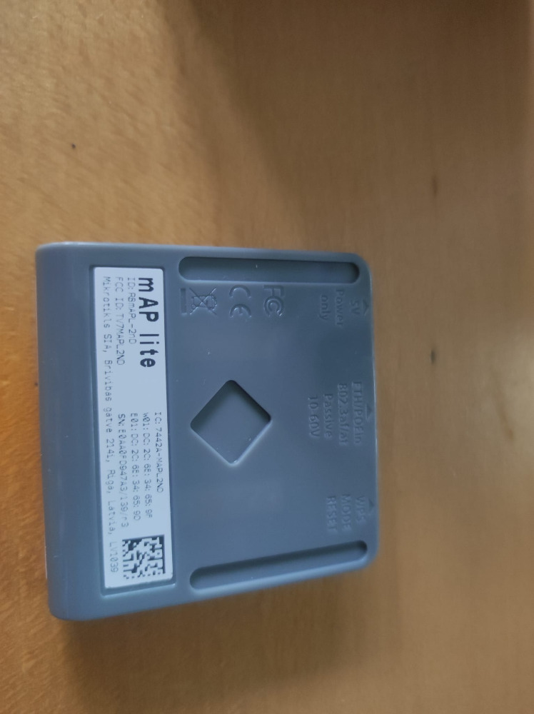

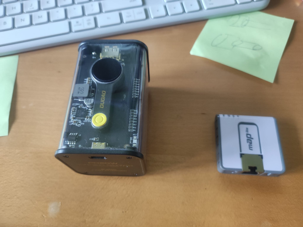

I had made a few adjustment for the scope adding a power bank(usb C 5-12V output) and wifi access point(there was no delay).
The same power bank (12V) i'm using for KTS 570.
