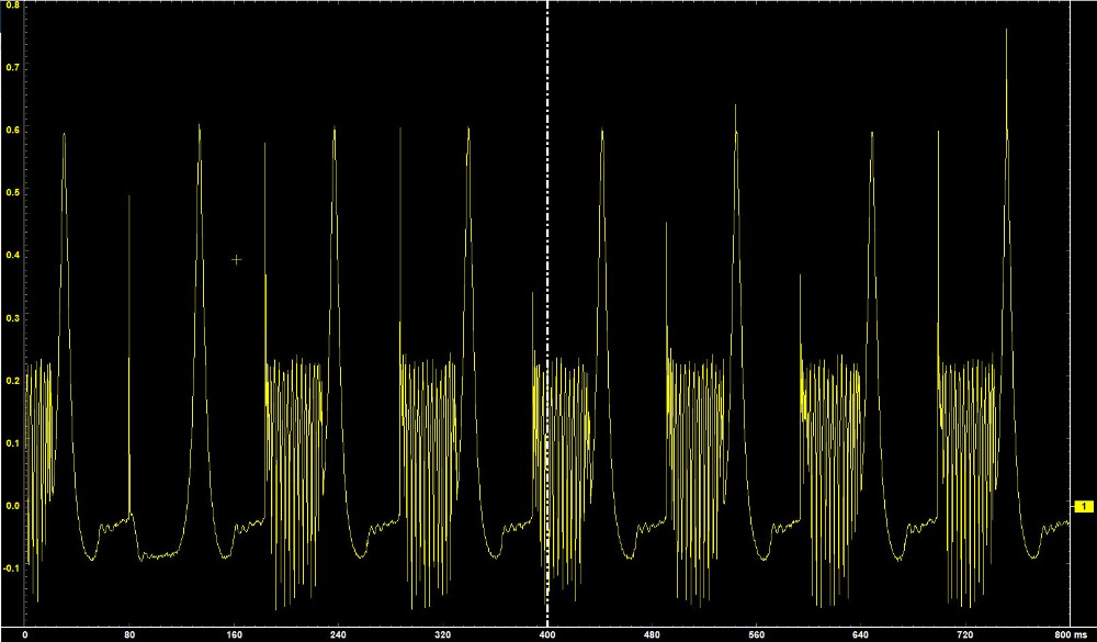

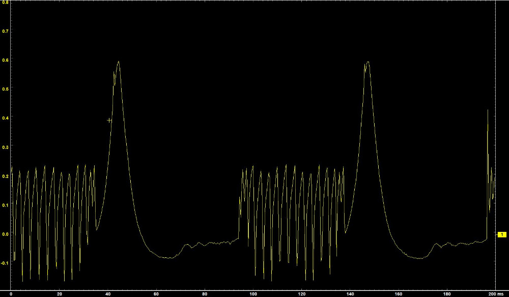

8 years 11 months ago - 8 years 11 months ago #15440 by Chad
Bad Compression waveform was created by Chad
2001 Saturn SL 1.9L Vin 8
I'm not posting this in the repair section because, I believe, I know the problem. I'm waiting for the "Go ahead", but I believe I am looking at a failed head gasket? I'd like to hear your thoughts.
Cylinders 1 and 2 look normal. Cylinders 3 and 4, both, look like this. This car runs, albeit a bit rough. Noticeable misfire. Short term fuel trim starts counting into the negatives. -1, -2, -3....all the way to...-35, -36, -37. When it reaches -37, it resets to zero. And begins counting, again. When it resets to zero, the misfires go away. The more negative the fuel trim goes, the misfires return and the rougher it runs.

8 years 11 months ago #15443 by Ben
Replied by Ben on topic Re:Bad Compression waveform
What are we looking at an in cylinder?
  • Chad's Avatar Topic Author
8 years 11 months ago #15444 by Chad
Replied by Chad on topic Re:Bad Compression waveform
Yes. Engine running. In cylinder pressure.

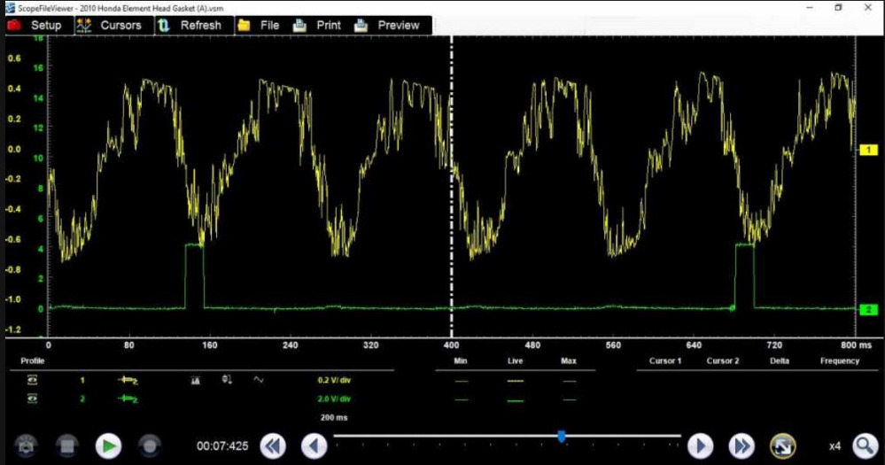

8 years 11 months ago #15447 by EricGoodrich
Replied by EricGoodrich on topic Bad Compression waveform
Could I ask you to perform a cooling system pressure waveform inspection with a cylinder synch? I believe a blown headgasket will show itself as pressure pulses in the cooling system.
8 years 11 months ago - 8 years 11 months ago #15449 by Chad
Replied by Chad on topic Bad Compression waveform
EricGoodrich wrote: Could I ask you to perform a cooling system pressure waveform inspection with a cylinder synch? I believe a blown headgasket will show itself as pressure pulses in the cooling system.
I like the idea. I'll have to see if I can connect the pressure transducer to the cooling system pressurizer, somehow.
I will, also, do a combustion leak test using the color-changing fluid. I didn't bother to do the combustion leak test because of the pressure pulses in the intake stroke of the compression waveform. Seeing that makes me pretty sure the head needs to come off. I haven't ruled out valve problems, but with both, and only, cylinders 3 and 4 being affected, it makes me think there's a head gasket blow out between the two cylinders?
Also, during the leak-down test, I had 25% loss. Which, according to the gauge, is considered low. I can hear it leaking through the intake.

8 years 11 months ago #15456 by Ro-longo
Replied by Ro-longo on topic Bad Compression waveform
www.scannerdanner.com/forum/diagnostic-t...-detection.html#4040
I did the pressure test with a know bad head gasket failure and with a known good engine, it can be done, but you would have to keep the water pump from spinning and you will see the same type of signal with a known good engine with no blown head gasket. So I wouldn't think it a valid test. I only did it on one vehicle. I would like to do the test on more vehicles but it seems that I never the time.
8 years 11 months ago #15461 by Andy.MacFadyen
Replied by Andy.MacFadyen on topic Bad Compression waveform
It has been tried and found there are fairly big pressure pulses in the coolant on a known good, the cylinder liners flex on every stroke so the leak would have to be so bad it was throwing water out the header tank anyway. In any even not all head gasket leaks are between the cylinder and the coolant, many of the HGF I see on modern engines with open deck cylinder blocks are between the coolant and the oil system.
8 years 11 months ago #15503 by EricGoodrich
Good to know.
What about a leakdown tester in each cylinder one at a time and a pressure transducer in the cooling system? I'd imagine it wouldn't take much of a leak to increase the pressure in the cooling system, especially if the cooling system were full of coolant.

Andy.MacFadyen wrote: In any even not all head gasket leaks are between the cylinder and the coolant, many of the HGF I see on modern engines with open deck cylinder blocks are between the coolant and the oil system.
I am suspecting that it is NOT to coolant OR oil.
I think I am only leaking compression from/to adjacent cylinders? But, as I stated earlier, I have not ruled out a valve problem.
Last edit: 8 years 11 months ago by Chad.
8 years 11 months ago #15510 by Chad
Ro-longo wrote: I only did it on one vehicle. I would like to do the test on more vehicles but it seems that I never the time.
Do you have an "AFTER" to compare?
I am inclined to agree with Andy.
That makes a lot of sense. I believe, that is what we are seeing in this wave. It is nice and uniform. I would expect to see some irregularity.

8 years 10 months ago #15664 by Ro-longo
I did, but I forgot to save the waveform, I did see a similar pattern. If I was smart enough I would have tried to look at amplitude but I was in a rush and totally missed the opportunity.
