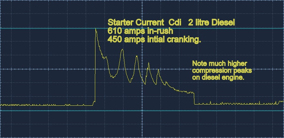

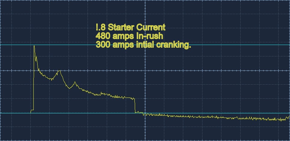

I did a couple of starter current captures comparing a 1.8 litre petrol v 2 litre diesel from the same car manufacturer both cars had same size battery fully charged in good condition.

Interesting. It looks like the diesel took more revolutions to start. A relative compression test comparison would be interesting. In the states we don't get to see many manufactures that have gas & diesel in the same models..
