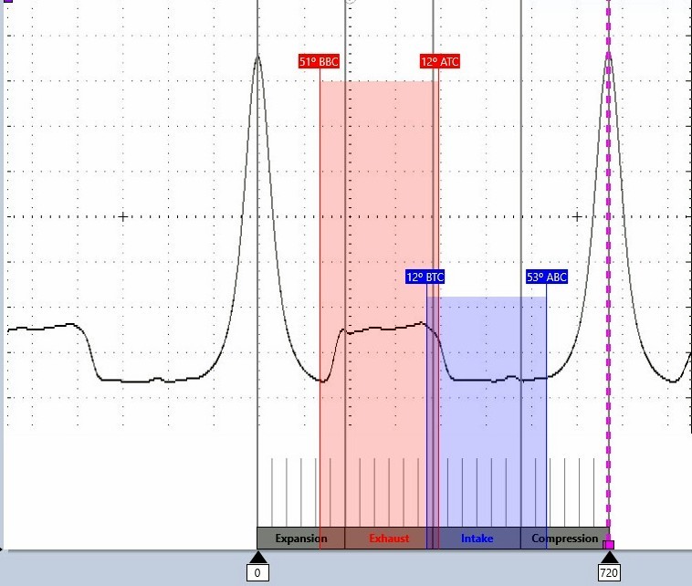

I use a homebuild unit I find the 0-200 transducer the most useful as it covers running compression test and WOT cranking compression test on most gasoline engines. GDI might need higher. The whole setup cost about £20, €25 or 30$ US
