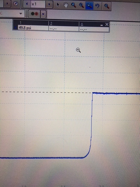

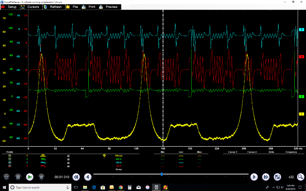

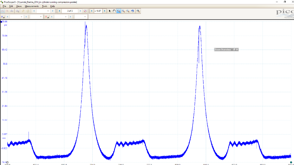

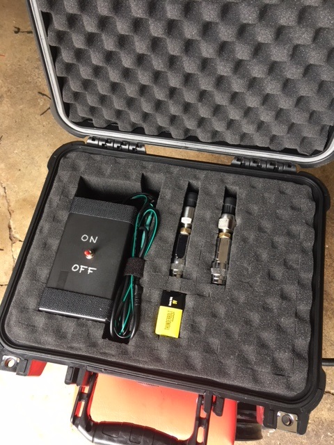

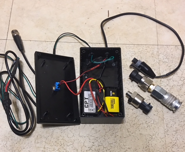

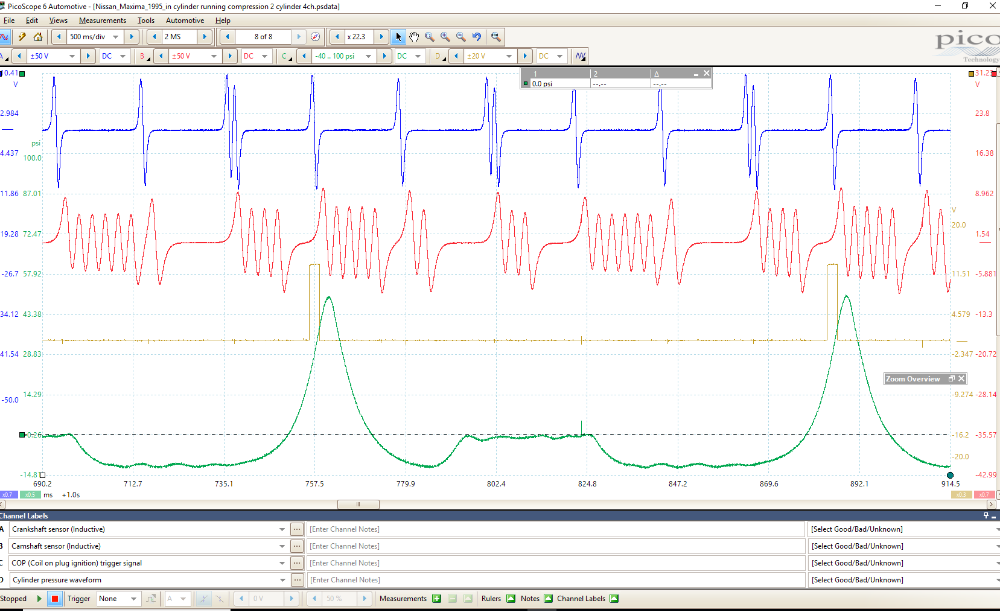

Built my own kit with 100 and 300 psi transducer. To test the 100 psi I set the compressor air to 50 psi. With the rubber tip nozzle I pressed it against the sensor and hit the trigger. it read 49.8 psi. Next was the 300 psi doing a in cylinder running compression on a 2014 Elantra. I noticed on the capture that on the exhaust stroke its not quite on 0 psi as I've seen on other captures from online. I customize my probe 0v = -37.5 psi, 0.1 = 0 psi and 4.5v = 300 psi. Maybe the settings need to be tweaked more? You guys can chime in. Last but not least bought the storage box from Harbor Freight with a their 25% off coupon. Happy Easter everyone.

Nicely done, it is a really good feeling when you get your successful in-cylinder waveform with a home build sensor.

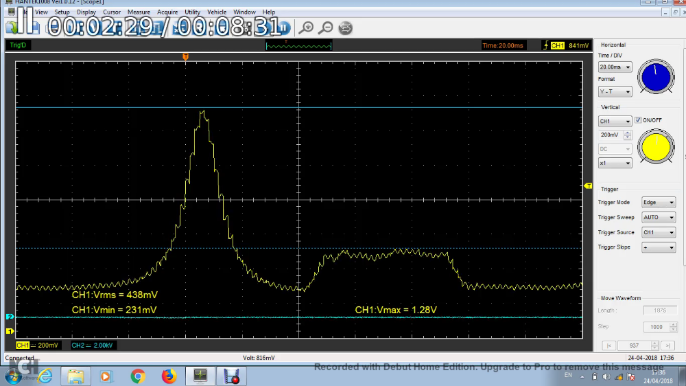

I just built my own transducer also, but took a slightly different approach. I used a Drok 2203 buck converter which takes between 22-8vdc input and outputs steady 5vdc. I could just carry around a 9v battery and connect it, but I'm cheap so I want to just use the car battery as my power source.
The problem I've run into is that AC from the alternator is being passed through and making my waveforms hard to read:
So I was thinking about taking a 0.1uF capacitor and hooking it across the transducer signal wire and ground to shunt the AC component to ground and clean up the signal, but I'm no electronics engineer and was wondering if someone here might know if that'll work.

After some testing, I discovered that it is the transducer itself generating that 40mv, 1 kHz sine wave noise:
I might try the transducer the OP bought and see if I have better luck.
8 years 6 months ago #20209 by SailorBob
Replied by SailorBob on topic DIY Pressure Transducer
After experimenting with various capacitor sizes I have laying around, I found the best results came from a 0.1uF mylar cap between the signal wire and 0V ref. It reduced the amplitude of the sine wave by almost 50%. Couldn't get anything better than that. However, I think the real problem is just that these transducers are cheap Chinese junk.

No eBay APP ID and/or Cert ID defined in Kunena configurationIt turns out that there were two problems. The buck converter was generating a 400 kHz 40mv sine wave on it's power output, and the transducer itself was also generating a bunch of noise. I was able to clean up the converters output with an RC low pass filter I made from a 47 ohms resistor and a 1uF cap.

here's the final fix. I was able to clean up the signal on the 200 psi transducer enough that it's useful for work:
