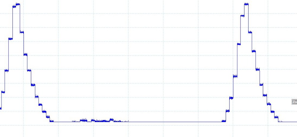

I can't get my DIY transducer to put up a clean waveform on my pico. The waveform is very "notchy." Ive made several adjustments to the settings but it stays notchy. But it does work, I diaged a plugged cat with it last week on a F150. Can't find the waveform, so I must not have saved it. Thinking about just buying the WPS next week

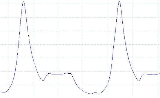

If by notchy you mean you can see distinct steps in the trace it would suggest the sensor is mis-matched to the range you are measuring. For a running compression test a zero to 200 psi works well. The one below was made with a zero to 300 psi sensor. Also of course switch the connection wires to either a twisted pair or co-axial BNC as close as possible to the cylinder. On the scope settings make sure peak detect is turned off.

Well I will have to do some more testing. I have a 100, 300, and 500. I think I've been using the 500
7 years 10 months ago #23725 by SailorBob
Replied by SailorBob on topic DIY Pressure Transducer
Set the pico to use 1 khz low pass filtering and that should clean it up. You're just seeing electrical noise probably.
7 years 10 months ago #23726 by bruce.oliver
Replied by bruce.oliver on topic DIY Pressure Transducer
SailorBob wrote: Set the pico to use 1 khz low pass filtering and that should clean it up. You're just seeing electrical noise probably.
It's not noise. I am used to seeing that on waveforms. It's like Andy described, distinct steps in the waveform. Like the transducer responds to slow for the software.

Ahh, I didn't understand what you said, yeah, the transducer just isn't responding fast enough, need a better quality transducer.
7 years 10 months ago #23800 by Andy.MacFadyen
Replied by Andy.MacFadyen on topic DIY Pressure Transducer
The steps are what instrumentation techs call the resolution which is the minimum change ( increase or decrease) in the pressure being measured. These cheap sensors have 8 bit digital electronics in their internal processing, this dosen't really matter much if a a sensor is chosen with maximum pressure in the right ball park for what you want to measure.

7 years 10 months ago - 7 years 10 months ago #23829 by Andy.MacFadyen
SailorBob wrote: I wouldn't say it doesn't matter - what you need to pay attention to is the Nyquist sampling rate - basically to accurate render the signal, in this case pressure changes, you need a transducer that can respond twice as fast as the signal changes. In dry air at 20*C air pressure changes propagate at the speed of sound, 343.2 m / s , which works out to 3.4 centimeters per millisecond. Or 1.34 inches per millisecond. So for in cylinder pressure readings I'd look for a transducer with at least a one millisecond response time, or really maybe even a little faster than that. Practically speaking, the one I use is rated one millisecond and it seems to produce good waveforms. When paired with 1 khz lpf I get nicely detailed clean waveforms.
Nothing to do with the sampling rate, in fact the steps are only really noticeable when the change is pressure is slow .
Take for a example a sensor rated at 250 psi ---- a sensor with 8 bit internal processing will only have 255 possible analogue output voltages so it will work in steps of approximately 1 psi.
On a 250 psi sensor a resolution of 1 psi steps is better than 0.5% of full scale is more than is required in any real world application.
But by matching the sensors max full scale range to what is being measure the size of the step change in output voltage is reduced choosing 100 psi sensor for running compression tests will improve the step resolution to 0.4 psi, but won't read high enough pressure for cranking compression tests which normally require around 200psi on older gasoline engines and can be 10 to 20% higher on GDI units.
It is of course fairly easy to smooth out the step changes with either an RC filter on wiring between the sensor and scope or on a scope with inbuilt software filters using a low pass filter but detail will be lost.

7 years 10 months ago #24311 by Sooknanan
Replied by Sooknanan on topic DIY Pressure Transducer
I believe i may be a victim of a crappy transducer. I bought 3 from amazon, tried the 0-300psi for a cylinder waveform and it came out like this.
Are any of my settings wrong that can cause this or should I just buy the transducer from the ebay link provided on page 1. Thanks in advance.
7 years 10 months ago #24312 by Andy.MacFadyen
Have you checked the output voltage against shop air -- wondering if you have been given a 3000psi sensor ? A lot of Chinese suppliers aren't too careful about what they send out.
