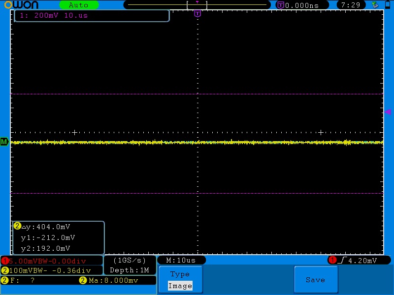

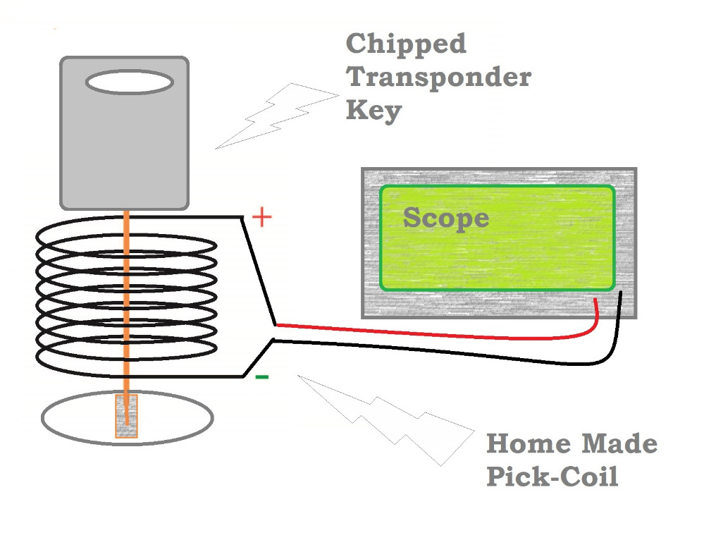

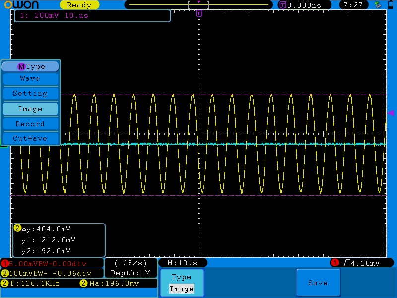

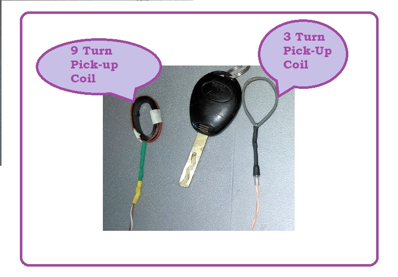

Simple way to use a scope to check if immobilizer is going into sleep mode --- captures are from a BMW EWS 3 immobilizer.
Basic schematic.
Home made pick-up coils. 3 turn and 9 turn coils wound using wire from old computer network patch cable, coil diameter has to be just large enough to fit around key, more turns of wire gives higher voltage but I found it works nicely with just a 3 turn loop..
Above simple home made pick-up coils,
Above EWS Immobilizer in sleep mode --- close to zero volts.
Above System awake key in steering lock , unlock buton pressed.
Above Key removed after a few minutes system goes back into sleep mode.
