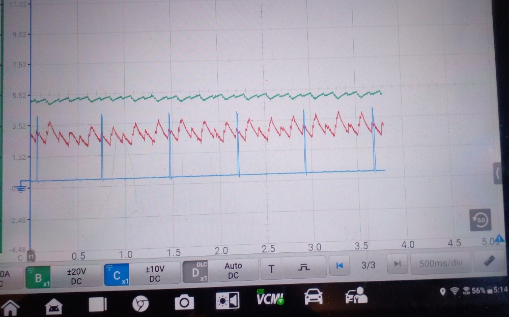

Hi guys hi every body
Gmc accadia 2008 with 3.6l engine
Check engine light on with code p0019 crank/exhaust cam correlation
is this image enough to make sure that the cause of the code p0019 is timming chain jumped issue?
thanks in advance for all of you guys

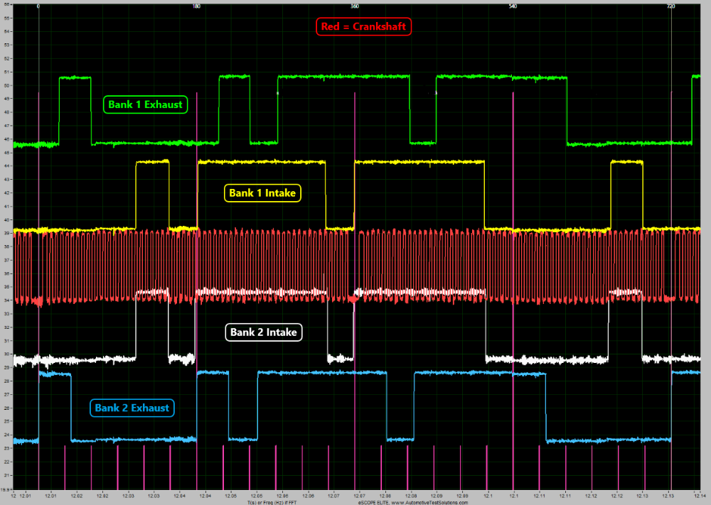

That image, definitely, shows a bant-to-bank compression imbalance. The most likely cause would, certainly, be a jumped chain.
Capture a cam/crank waveform and compare it to this known good, if you you have any doubt.

Thank you so much Chad
awesome capture
awesome capture
