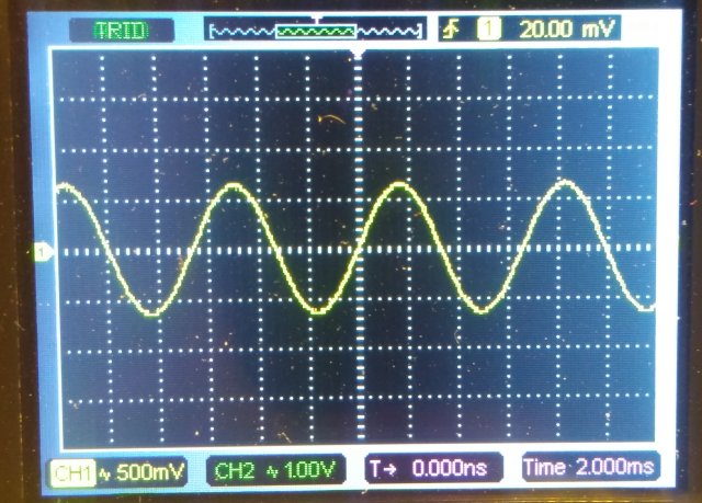

7 years 6 months ago #28786 by Andy.MacFadyen
Be aware Hantek hardware quality is shall we say 'variable".
As with most Chinese oscilloscopes the speed is overclaimed divofe it by 4 .
7 years 6 months ago #28787 by Andy.MacFadyen
As with most Chinese oscilloscopes the speed is overclaimed divide it by 4 .

7 years 6 months ago - 7 years 6 months ago #28937 by bbarry
That may be true. I run into that on lipo battery capacity, never seems to be the stated capacity. I did check this unit thoroughly when I received it and could not be happier with its performance. Here is a pic of the scope with 40Mhz signal input from a HP generator.
More then adequate for automotive testing.
