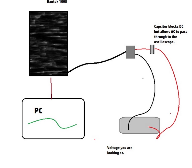

7 years 2 months ago - 7 years 2 months ago #32903
Replied by Andy.MacFadyen on topic New to Scopes need some guidance
The pre-sets in the Hanatek 1008 program actually show which probe to use if you are using one of the pre-sets the program won't let you change the probe attenuation. Hantek pre-sets automatically select a 20:1 attenuator for both injectors and coil primaries and won't let you change the setting.
One thing the Hantek lacks is an AC setting it shows DC. The showing only AC is useful for cranking compression tests and alternator ripple tests. You can make an DC blocker by making a lead up with a capacitor in series the posative lead going to the scope
The blocking capictor prevents any DC reaching the scope so only the AC ripple shows and you can adjust the on screen volts scale to give a moe detailed view.
Two automotive oscilloscope manufacturers Pico and Ditex have a great deal of information on their websites, Pico guided tests autoditex.com/ are a really great source of information and so is Auto Ditex autoditex.com/
The Ditex Carscope demo program is a good program to download and run, the demo version runs slowly but shows very clearly what probe to use and has a great help secion. Unlike Hantek Ditex are putting a great deal into developing their automotive diagnostic range.
autoditex.com/page/common-rail-injector--piezo-crip-26-1.html

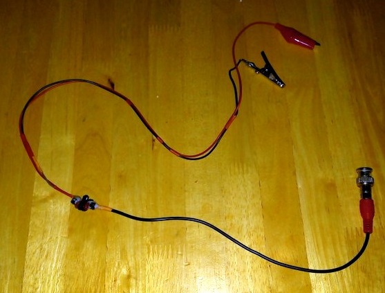

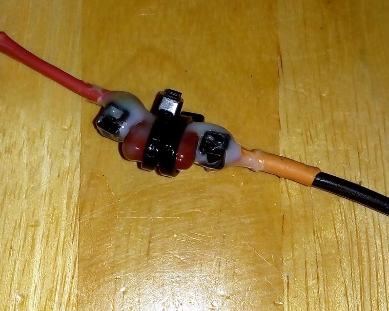

7 years 2 months ago #32907
The capacitor was a small poly polyester film capacitor I used a 400v voltage rated type. I cant recall capacitance probably 0,47uf but I am pretty sure smaller would work
