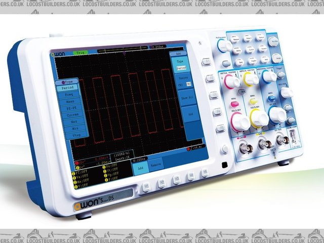

Bench scopes with the main exception of some of the Owon models are hampered by the need for mains power supply. Even on the Owon SDS with the optional battery pack especially the faster models the length of time working on battery power is limited --- considerably shorter than the manufacturers claims.

On the otherhand if you want a simple starter level PC USB general purpose scope at a bargain price checkout the Owon 11022i --- it is a lot better than the Hantek 1008 but will need input attenuators for checking coils and injectors
