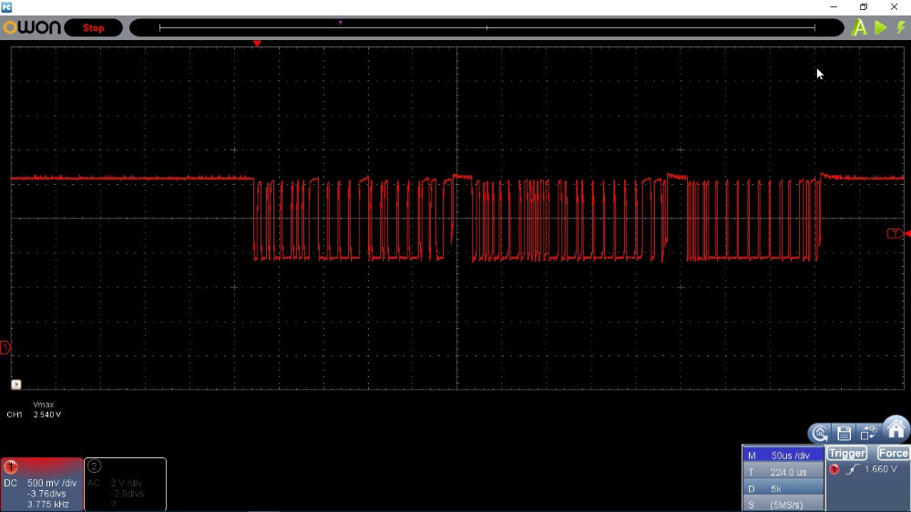

The screen on my modis has been very difficult to see and I now need a backup scope.
I need at least 2 channels and I’ve been looking at the Owon 1022i and the PICO 2204A and PICO 2205.
Are any of these scopes fast enough to capture HS-CAN?
6 years 10 months ago - 6 years 10 months ago #35942
Replied by Andy.MacFadyen on topic Need a Temporary scope
Can low Owon VDS1102i connect to bosch 5.7 ABS so it should be high speed the back probe was a bit iffy time base can be set allow greater detail if required. --- should be no loss of quality when using both channels as they have seperate processors.

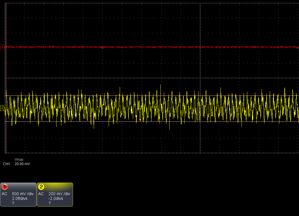

6 years 6 months ago - 6 years 6 months ago #39254
4 second or 10 second screen (200 or 500ms/div) and you can zoom in.
Alternator Ripple test 4 second screen
