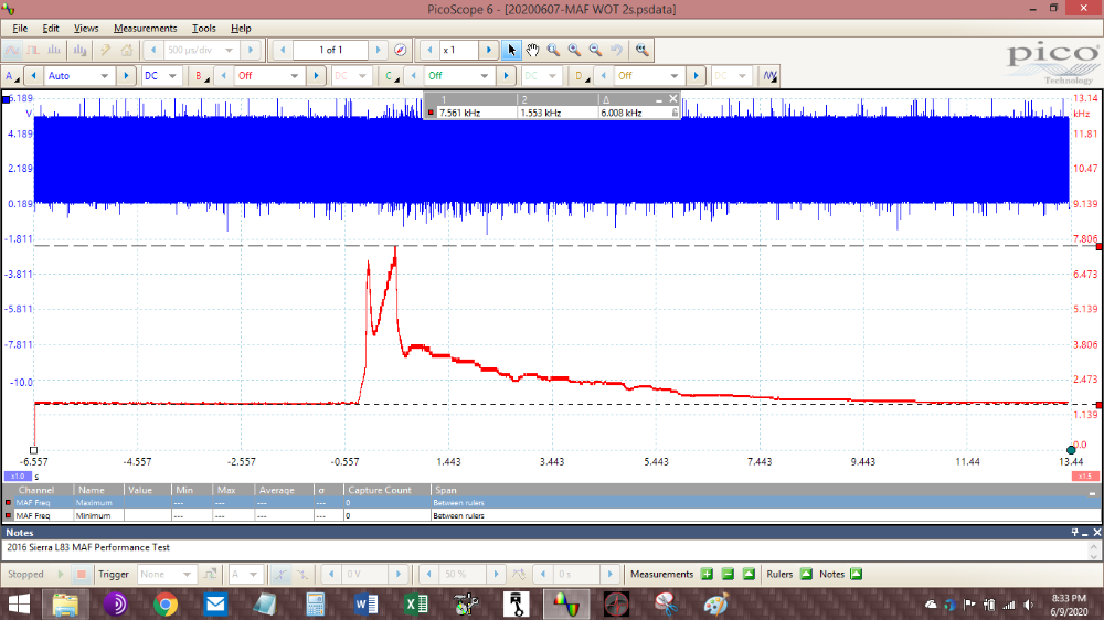

Does a tech need a Pico?
Above Photo is a MAF performance test. And someone told me I couldn't measure frequency with my Pico !!! BTW 7.5KHz is good and healthy.

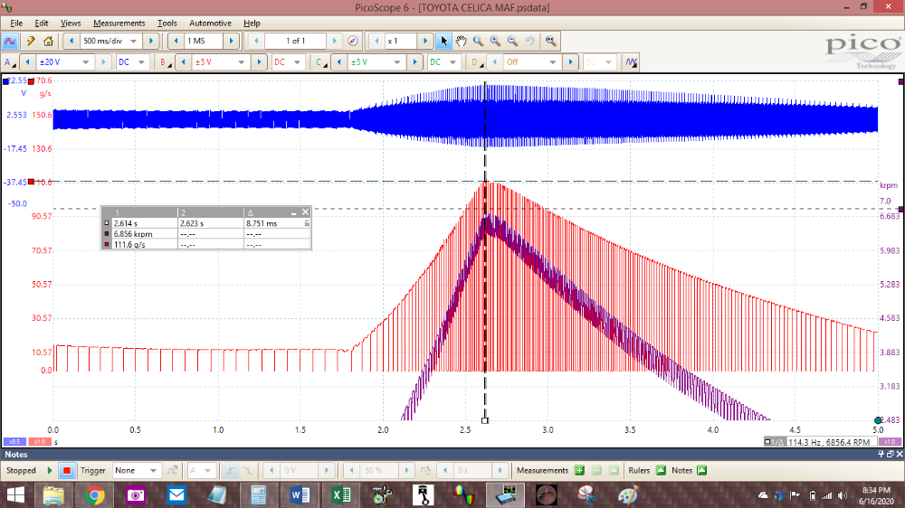

In this photo, we are measuring RPM and the Theoretical Output of the MAF, which can be compared to scan data. This is all solely based on the CKP signal.

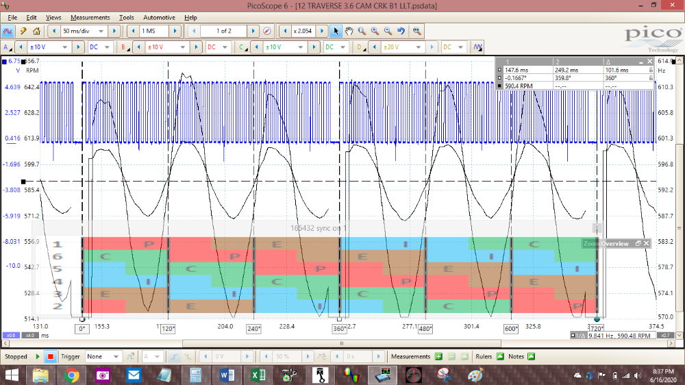

Here is a real beauty, the smaller black trace is the crankshaft accelerating(moving up) and then decelerating(moving down). This is solely achieved from the CKP sensor alone. Wouldn't this be a very useful tool in Mis-fire Diagnostics? Oh look... that cylinder did not contribute to acceleration on that piston's Power Stroke!!

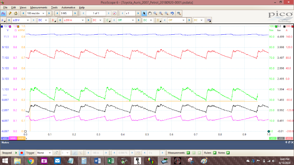

Dynamic Ohm's, Power, and Toque. But the use of OHM's law is the best, I can measure Voltage, Current, Pico can figure out Resistance
