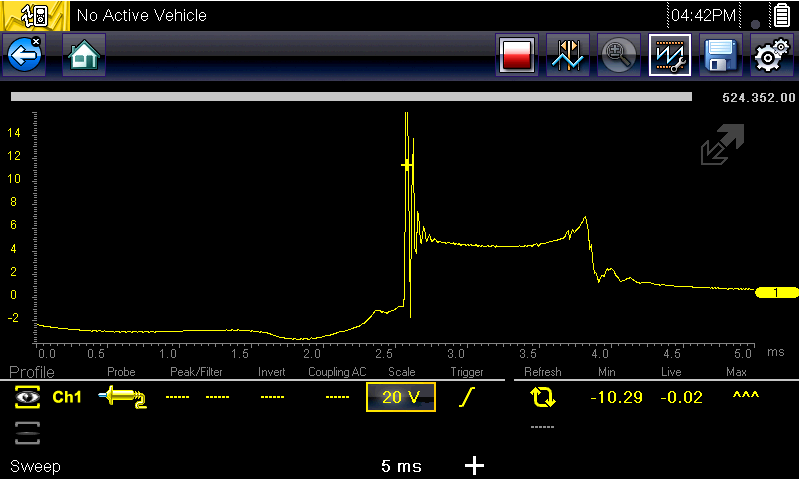

Here's a couple examples on Toyota four-wire coils. First is a normal event at idle:

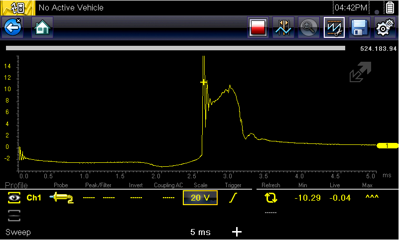

This had an oil fouled spark plug:

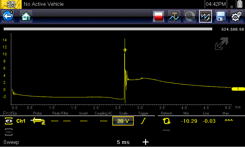

This had no spark due to a shorted secondary winding:

So... as a noob can you explain to me the difference with the three patters? Ok how about I guess and you tell me if I am right :P. The first one is good obviously. The second one, I see that there is a lot less of a drop in the voltage and the second spike occurs much sooner than the good example. (what does this indicate?). The third on has the large spike, but no event following it.

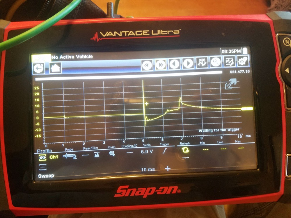

So I scoped my first ignition coil (just using a handy-dandy alligator clip right now). This is on a 2012 Dodge Challenger. So what data and information can I gather from this? I am assuming it is a good coil since it runs fine... I just really don't know what I am looking for I guess. Also, since this car has two spark plugs per cylinder, does this change the waveform in any way?

Congrats to your first coil oscilogramm 8-)
Not really too much detailled information in it yet, you got ~ 4 ms dwell time for coil charging and almost 2 ms of burntime. The dwell time is pretty standart and the burn time is at the higher end of normal.

AJeep18 wrote: Also, since this car has two spark plugs per cylinder, does this change the waveform in any way?
That change during the burn, about 1.2 ms in, might be the spark extinguishing on one of the plugs.

So how can I get more detail in it? Just by playing with the settings? What type of detail should I be looking for? Also what is a normal burn time, and what does a longer one indicate.

A "normal" burn time would depend on the ignition system your working on...
A distributor system in good working condition with one coil will feature anything between 1.5 to 2 ms at idle, whereas a waste spark system may go well as low as 1ms and still be o.k. most of the COP systems again will hover around 1.5 ms
With burn times below 1 ms problems may start..... Less then .8 ms will result in misfires.
If the burn time is too high the resulting spark may be not hot enough to ignite the fuel mixture properly, more than 2 ms raises my suspicion with a given problem.
Secondary ignition waveforms , together with in cylinder pressure oscilograms, are the waveforms that reveil a wealth of information about an engine's working condition. Indeed, it's so much that we can't summarize it satisfactorily in a thread like this one...

The second one definitely has a burn time issue, mostly because the gap of the plug is fouled with stuff that's not air or fuel. Everyone has different rules of thumb? I look for 1.0 to 1.5ms of burn time on most COPs.

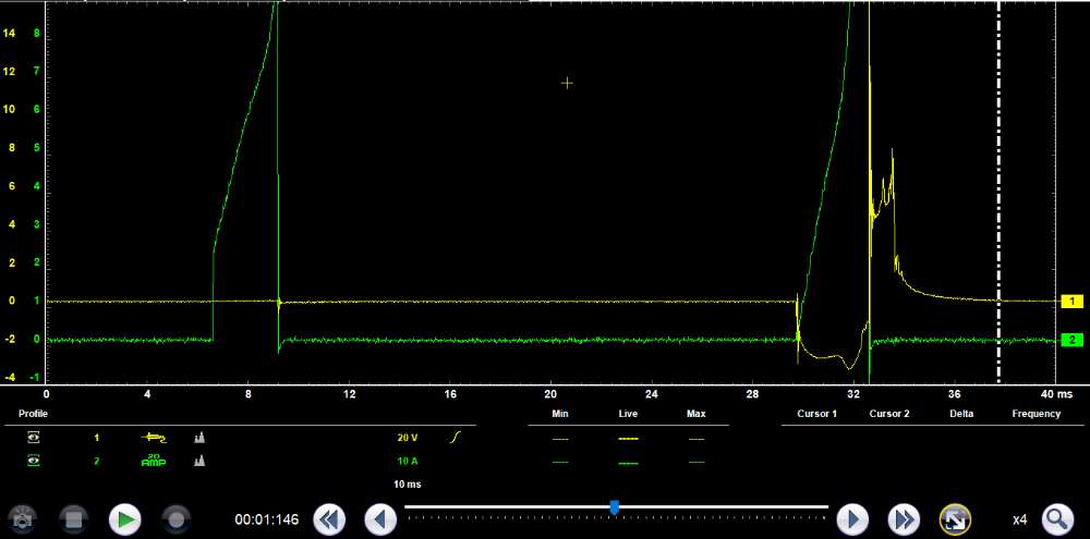

You're right about the third, with no event. That's the clue that no spark is taking place, in the cylinder or otherwise. That same coil had a bad current ramp to go along with it:
