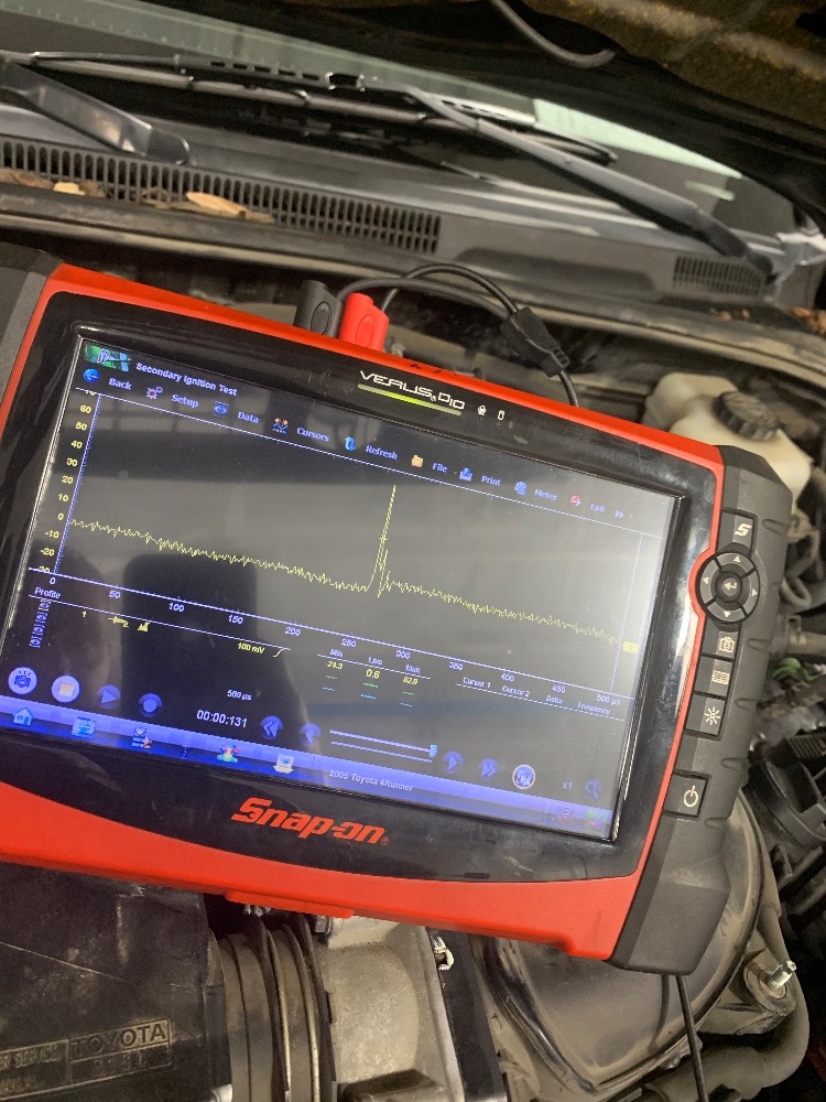

6 years 3 months ago #41232 by Jonathan Haffer
Secondary paddles was created by Jonathan Haffer
I couldn’t get a good waveform no matter how I set my scales, any suggestions?
Jonathan Haffer
6 years 3 months ago #41242 by Tyler
Replied by Tyler on topic Secondary paddles
What paddle were you using?
You're on a Toyota COP, it appears, which are notoriously difficult to test with a secondary pickup. :( Strange as it sounds, but you may have better luck with just an alligator clip. Here's a couple threads worth reading:
www.scannerdanner.com/forum/diagnostic-t...secondary-probe.html
www.scannerdanner.com/forum/lab-scope-di...need-to-buy-one.html

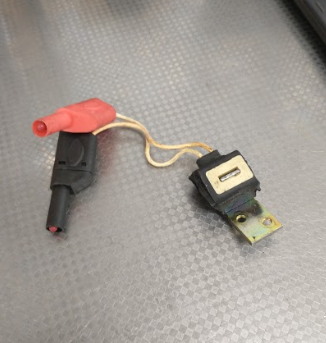

6 years 3 months ago #41271 by Tyler
You can do eeeeeeet! :cheer:
Here's what mine looks like. Not elegant, I know.

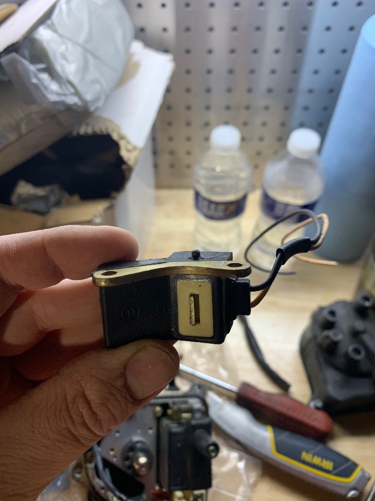

6 years 3 months ago #41273 by Jonathan Haffer
Replied by Jonathan Haffer on topic Secondary paddles
This is what mine looks like, it looks a little different than yours

6 years 3 months ago #41299 by Tyler
Good to know Honda the exact same pickup for years and years. :silly:
The magnet is still in there, so start grinding on the end furthest from the wires. Eventually you'll uncover two Phillips screws that hold the magnet on. Spin them out and you're home free.

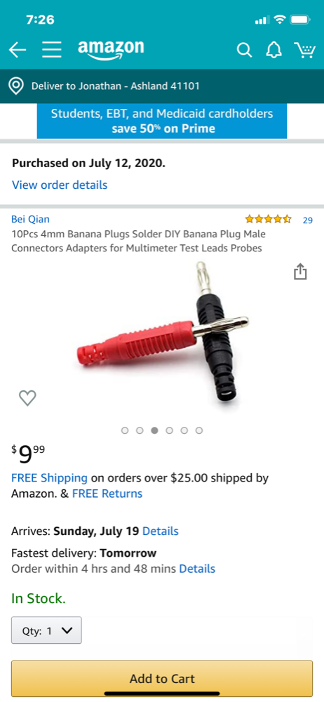

We’re are you getting them banana plugs ? I ordered these , I couldn’t find the kind you got,
Jonathan Haffer

Jonathan Haffer wrote: We’re are you getting them banana plugs ? I ordered these , I couldn’t find the kind you got,
"Stackable banana plugs" should pull them up on amazon and ebay. It's either those or "safety banana sockets" you really need for something like that pick-up so you've got a female to plug your test leads into. If you use regular plugs then you'll also need couplers to connect them to your leads.
