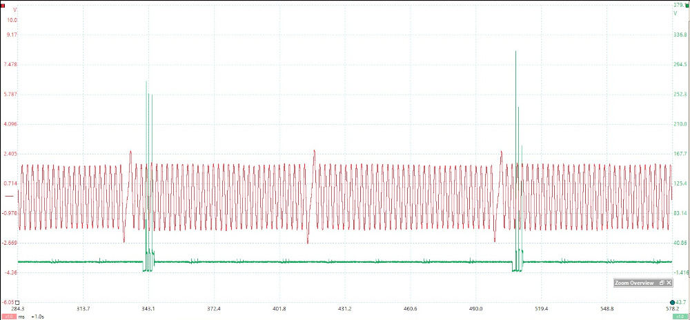

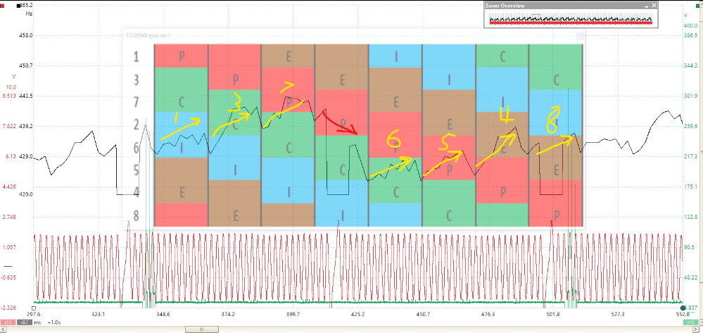

This waveform contains all the information needed to identify which cylinder is misfiring.
RED = Crank Signal
GREEN = #1 Primary Voltage
If we add Crankshaft Frequency, (BLACK Trace) by creating a "Math Channel", we can see the Crankshaft slow down, due to the misfire.
*ignore the HUGE drop-out in the BLACK trace. That is caused by the missing "Sync Notch". The Math Channel interprets the missing tooth as a BIG speed reduction.
Adding a Piston Position Chart, we can see the Frequency of the Crankshaft increase with each Power Stroke, except Cylinder #2. The Crankshaft slows down during #2 Power Stroke, indicating insufficient combustion.

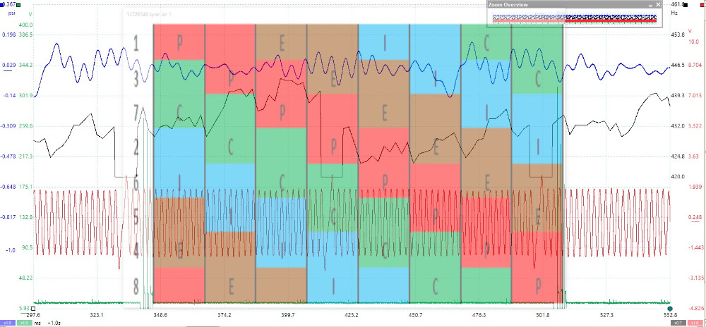

This image contains all the information needed to identify which cylinder is misfiring AND indicates which Valve is at Fault. :cheer:

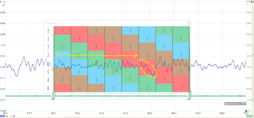

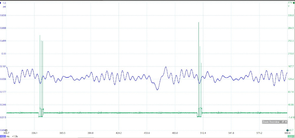

BLUE = Pressure Transducer in the Tailpipe
GREEN = Cylinder #1 Ignition Coil Primary Voltage
*This is a RUNNING @ Idle Waveform*
Using a Piston Position Chart, we can see that when the #2 Exhaust Valve opens, the BLUE trace falls into a vacuum. This indicates a misfire on Cylinder #2. (Remember the Old-School "Dollar Bill Trick"?)
The BLUE Trace has another anomaly, too. Notice that, when Cylinder #2 comes up on Compression, Tailpipe pressure, slightly, rises instead of the normal oscillation. This indicates that Cylinder #2 exhaust valve is leaking.

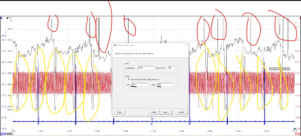

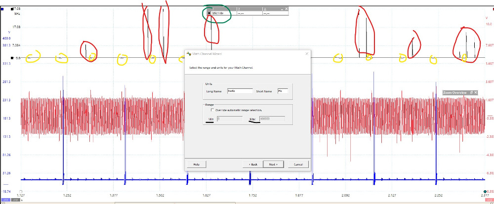

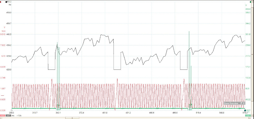

This is a picture of the Frequency Math Channel at it's default Range (zoom level).
The Black trace is the Crank Frequency. The upward spikes (RED) can be ignored. With some filtering on the Crank signal, these will disappear. The YELLOW circles are the Sync notches. They are, merely, bumps at this zoomed out range.
The over-all Frequency of the Crankshaft signal is 389.1 Hz (GREEN).
If we edit the Frequency Range to a Min/Max of just below/above the overall frequency, we can Zoom in. The upward spikes (RED) can still be ignored. The HUGE downward spikes (YELLOW) are the Sync Notches and should be ignored. Comparing the little (yellow) bumps, from the above image, to the HUGE (yellow) downward spikes in this image, show how far in we are zoomed. Ignore the sync notches.

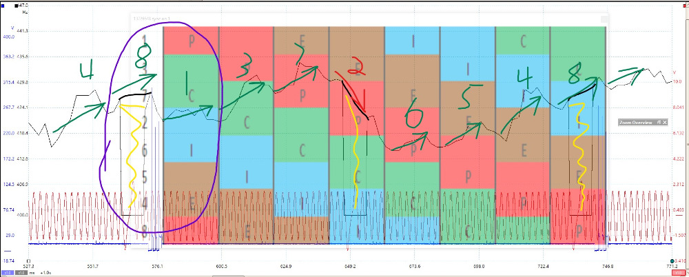

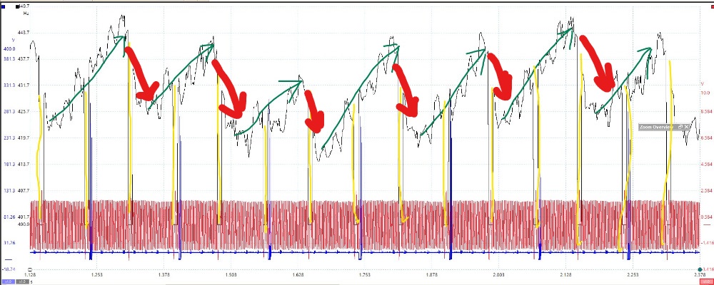

This next image is zoomed in a little farther on the frequency. It has some filtering on the crank signal. This eliminated the upward spikes. Here, we can clearly see a repeating upward pattern (GREEN), indicating Crank acceleration. In RED, we see the downward Deceleration, due to the misfire.
Zooming in farther and adding the Piston Position chart, we can see that the pattern repeats its downward deceleration at Cylinder #2 Power Stroke (RED) . All other Cylinders show an increase (GREEN) in frequency during Power Stroke.
What I have circled in PURPLE looks like the frequency dropped from Cyl #8 to Cyl #1. It didn't. This is an illusion created by the sync notch. Ignore the sync notch.

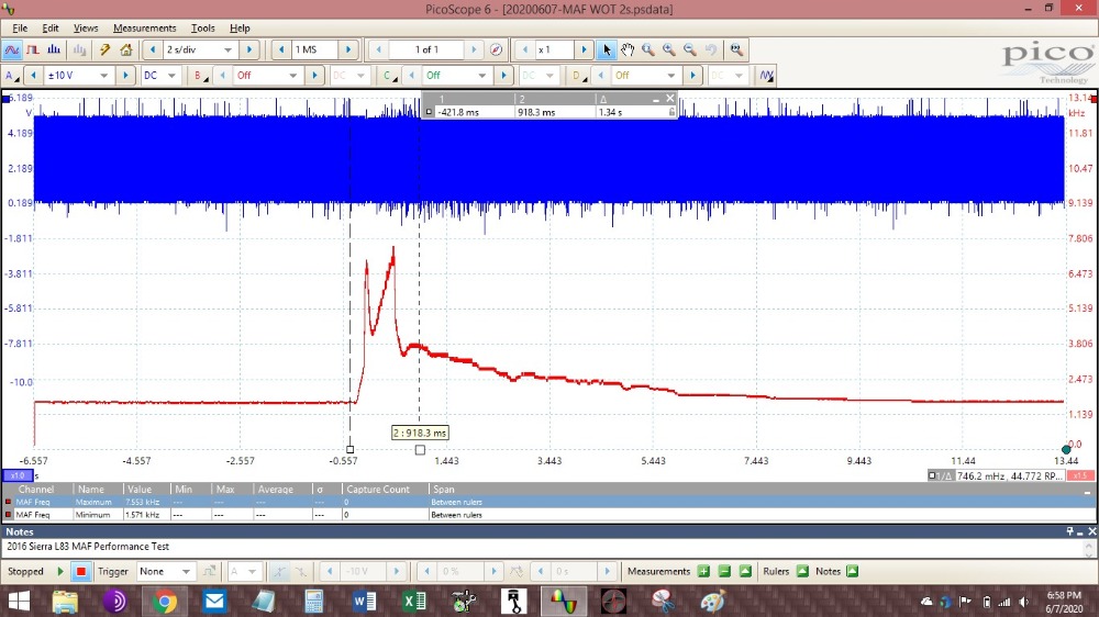

This is a 2016 GMC Sierra 5.3 @ WOT climbing a 7% Grade.
MAF maxed out @ 7.5kHz which is spec.
