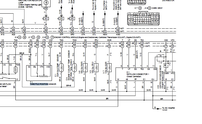

Recently I purchased a Pico 2205A and still learning it. I am using some test probes I had for an old Textronik analog 100 MHH.But recently I am suspicious of the state of the probes I am using and do not know how to ensure they are good or bad.Testing the IDL signal on the 4Runner TPS I found a glitch at a spot on the signal for E2 (ground) and the VTA reporting to the ECU the TPS position.
Will it be OK to use straight cables from the SCope to the TPS instead of the probes I have?

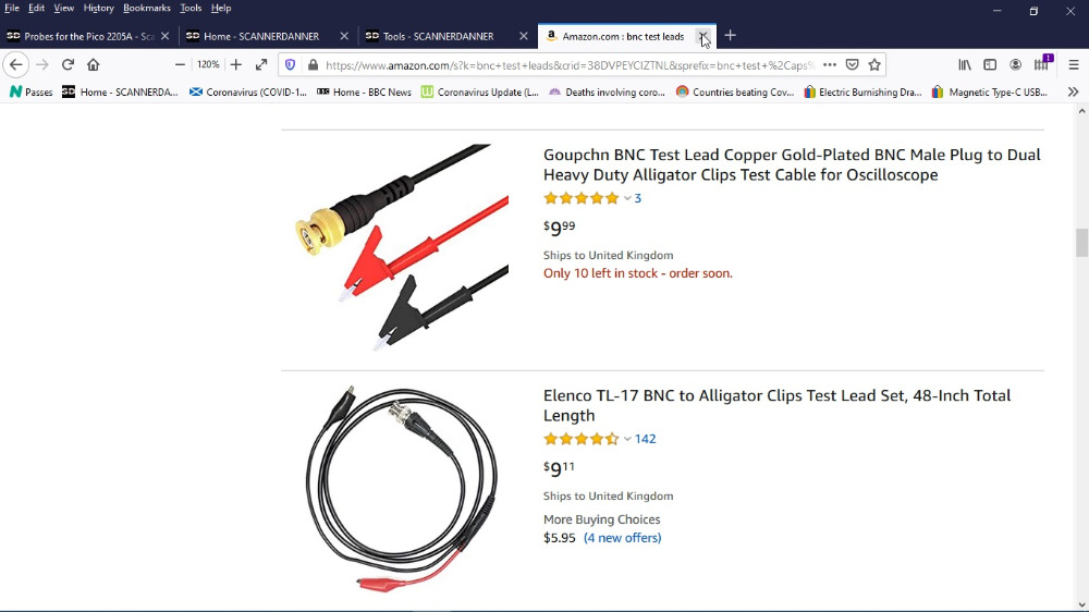

For automotive signals in the sub 20v range you can use plain BNC test leads. Using normal Labscope probes can short are great for woeking on a circuit board on the bench but are too easy to short out when working under the hood. You can also use BNC to 4mm banana adaptors. and BNC extension leads Here are a few on Amazon

Thanks for the advise on the probes from Amazon, will be ordering today.

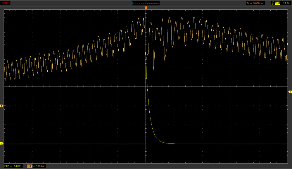

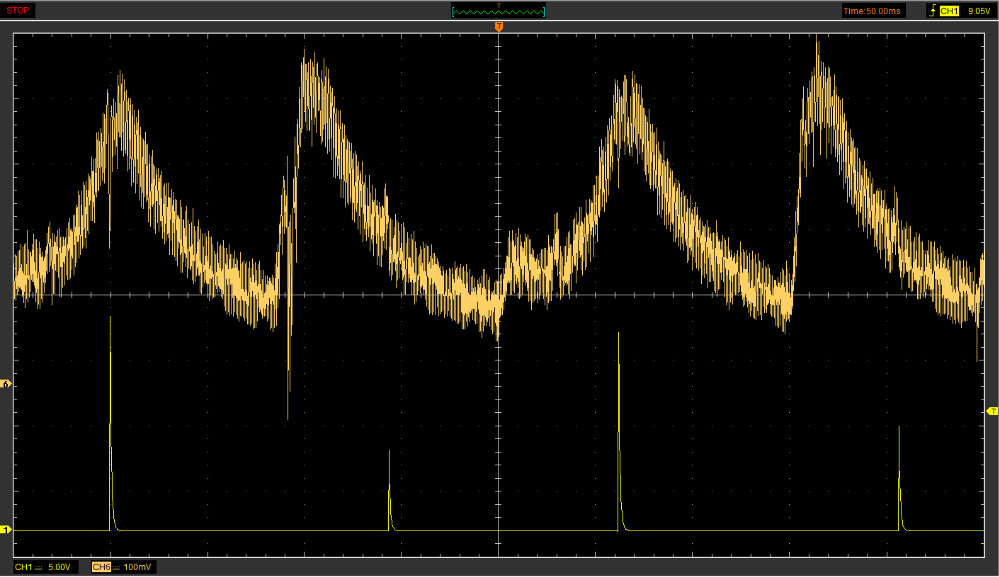

For a sync signal I prefer an inductive RPM pick up. It's a much cleaner signal so it's easier to get a reliable trigger with. The one I use originally came with a MAC automotive DMM so you might already have one. It's the yellow, Ch 1, trace in the pics.
Replied by Matt T on topic Probes for the Pico 2205A
Batiscafo wrote: Y may have to buy another HT-25 just to use a trigger otherwise.
