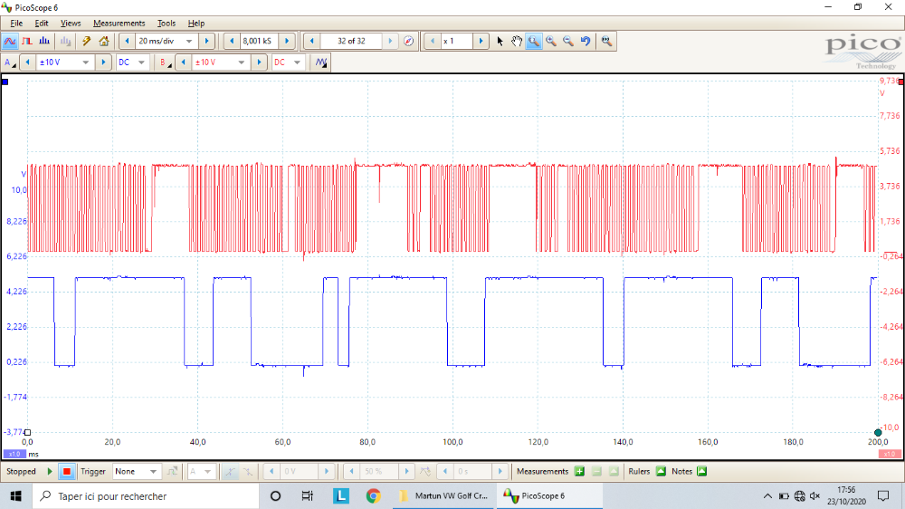

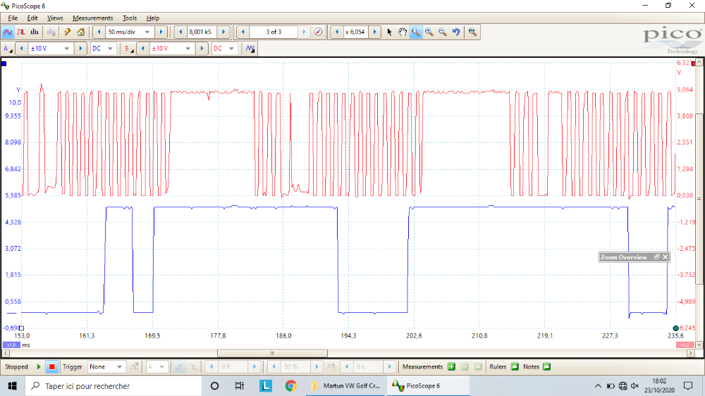

Hi Everyone,
My name is Fadi, I am in France working on a car for a friend, and I am looking for a Waveform of the correlation of camshaft vs crankshaft for a VW Golf Plus model 2006 diesel engine, engine code BLS.
I have attached two screenshots of the waveform I took on my Pico on this car, the Red waveform is the crankshaft, and the Blue is the camshaft.I need to know if the engine has good timing.
Thanks a lot
Best Regards,
Fadi

Replied by Matt T on topic Cam Crank Correlation Waveform Golf Plus Cross 2006 Diesel Engine Code BLS
Hi Fadi,
I'm not sure about timing but your crank signal looks bad.
