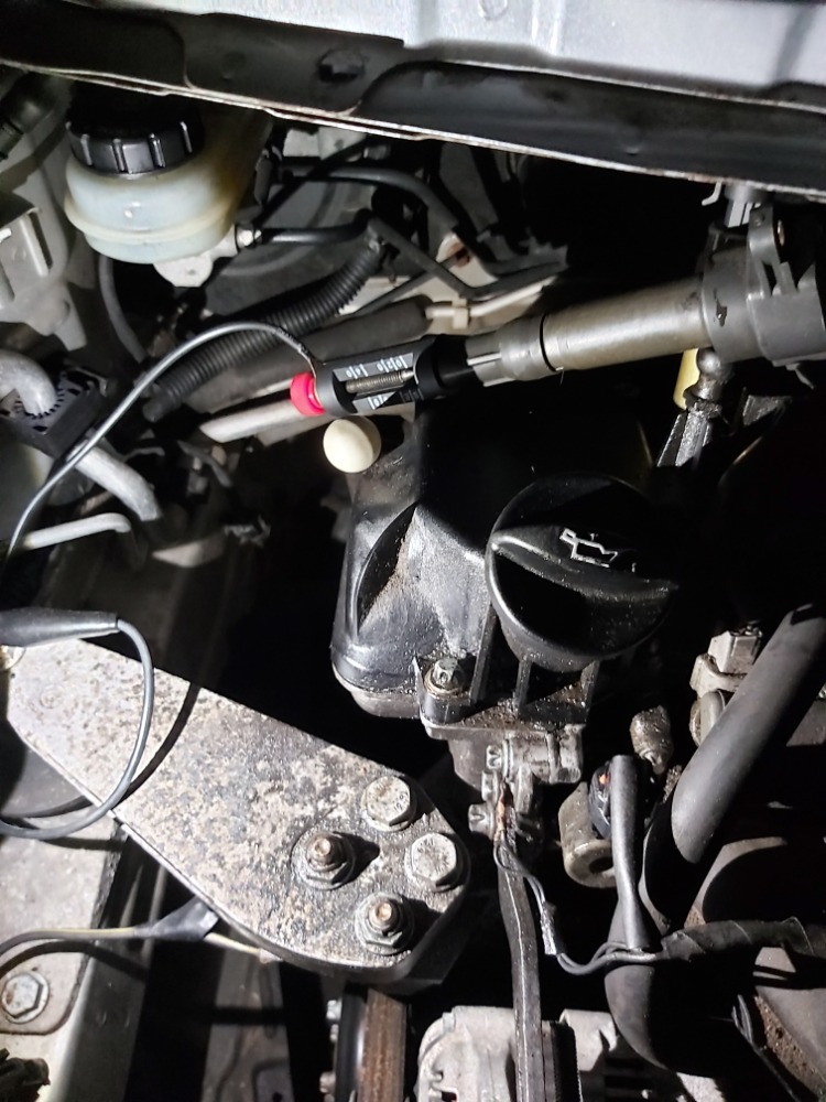

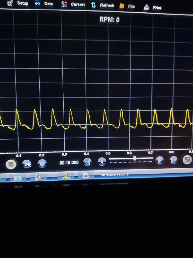

Using a 500psi pressure transducer in-cylinder to try and get a reading on my Verus Classic,first time i've tried it,fuel disabled,just cranking,this is what i get???Looks like i've got Bart Simpson trapped in there!Doh!
I'm using correct 500psi setting in scope.

5 years 11 months ago #44208 by Chad

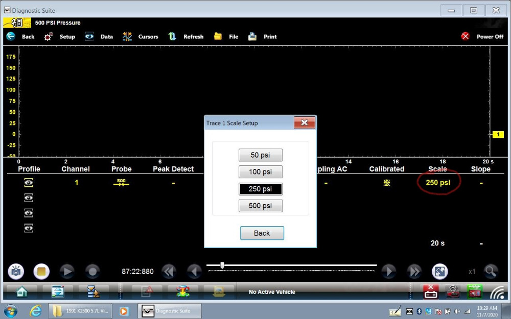

I have never used a Snap On pressure transducer but, I would recommend reducing the range to a 250 psi scale and change the time base to a 1 or 2 second screen. If that doesn't produce a better wave, then I would change the probe input to Test Lead - Volts DC. Set the voltage scale to the output range of the transducer.

Don't know if you can adjust the psi scale,it's 500 or down to 100,in the presets anyway.I'll see if there is a way to adjust psi scale though,still familiarising myself with the snap-on.
If that fails i'll try your second suggestion,thanks for replying!Lee.

First off is this a Snap-on transducer or something else? If it is something else use voltage instead of the transducer presets.
Looks like you've got way too much time on the screen. That could be killing the sampling rate. Knock it down to 1 second and see how that looks.

I've tried all different time scales,still get similar pattern.I also tried doing it on a 5v scale and it never picked up a trace.
I'll maybe try a 2v scale tomorrow and see how that goes.

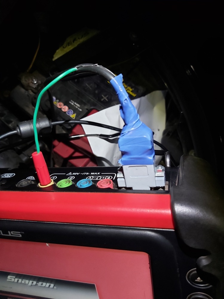

The transducer i made up according to the instructions i found on this site,comprises of positive wire,and ground soldered to two pins of a 9 pin connector which is plugged into the'aux' input of the verus,one wire left (signal wire)is soldered to a banana jack which is plugged into the first channel of the scope.

5 years 11 months ago - 5 years 11 months ago #44221 by Noah
Must have used Paul's very well put together tutorial :)
www.scannerdanner.com/forum/diagnostic-t...-transducer.html#859
When you get the schrader valve out of there, I'd be curious to see if you can verify the accuracy of the pressure scale.
My particular sensor does not coincide with the pressure scale and on the Verus Edge, if you aren't using that preset, you can't use the 9 pin for power and ground.
For those reasons I abandoned the 9pin in favor of power and ground via USB.

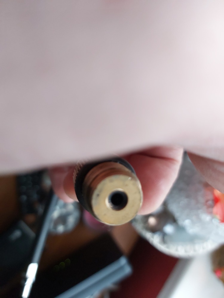

I think there was be some other valve inside the hose i have screwed into my spark plug hole,but you can't get it out!!You can't get in there and unscrew it. :-(
Here's a pic of what im screwing into the spark plug hole.I'm pretty sure everyone who is going to do their first in-cylinder scope test will just turn round and grab a hose off a standard compression tester they may have and think it will work?
A lot of people probably don't expect this problem.I might just drill it out then blow out the debrus.

Managed to get there in the end,problem was just the extension i screwed into the spark plug hole,i used one from an old manual compression tester,it must have had restrictions in it.
I bought a hollow brass tube that screws into the spark plug hole,then just screwed in my cheap Chinese 500psi transducer to the top of it.

5 years 11 months ago #44618 by Noah
Nice, glad you got it working!
If you would care to share a picture of the waveform with us, I would like to see it.
You may not need the Pico just yet, you can squeeze a bit more out of the Verus.
Try setting the time base much lower.
It will look like garbage until you pause the capture, then press the zoom button (magnifying glass in the bottom right corner). That will zoom all the way out on the pattern. From there you can zoom in and out until you get one or two repeating events on the screen.
You can then drag your two vertical cursors around.
I've even seen someone turn on a second chanel just to have a horizontal line on the screen as another cursor.
You can also try a/c coupling the waveform. It's going to throw the voltage scale scale off, but without some more testing, you probably won't have an exact pressure to voltage conversion yet any way.
