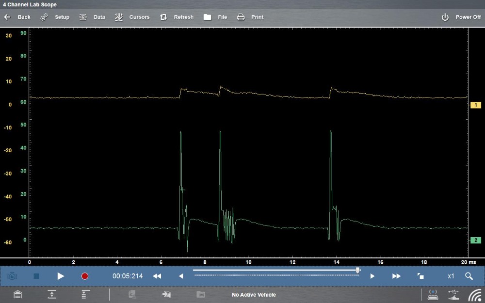

Just thought I would drop these waveforms I captured off a 2012 Ram w/6.7 cummins engine. Although not exactly the same, similar to gdi waveform. The one on the left is bad with no fuel being injected, and the one on the right is known good

i have a 2008 im fighting right now. I have a very poor running condition. intermittently will idle only any throttle will make it fall on its face. sometimes it will crank and crank and never fire with no smoke out the tailpipe.
I have checked injector voltages when running but very poorly and my injector voltages are much lower than what I believe to be normal. Im only seeing about 20 volts at the highest on my driver side. my ground side looks very similar to what you have posted as a bad signal.
We have gone over all pcm grounds and powers, load tested all injector circuit wiring back to pcm through the UVCH and checked out ok.
What did you find to fix your low voltage?
